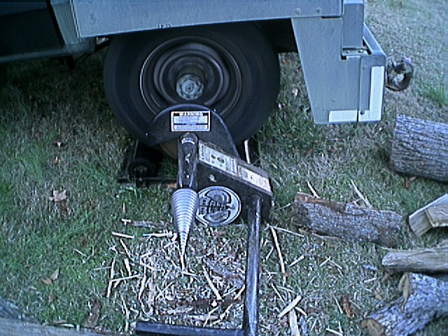

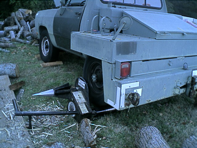

I had been using one of my my jeep cherokees to split wood since it is the only thing with a open diff.
I thought, "I'll use the 90 tug to run the Barkbuster for a change.", It does take a little more setup time to put the passanger side up on blocks, since it has a detroit locker in the diff, and jack up the drivers side since the low bumper wont let me back onto the rollers.

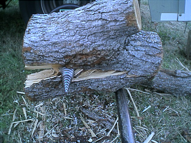

I am pleased with the results, 15mph in drive with 7.17 gears worked like a charm, a lot of the big wood would stop the tire on a 4.0L jeep in low gear @ 15mph, with the 6bt ya don't even hear the exhaust note change in 3rd, wood squealing, tearing and smoking!
it just keeps on going.
As a bonus I think I'm gettin more WPG (wood per gallon)
Just thought I'd show one of the odd uses for a 1st gen
it just keeps on going.As a bonus I think I'm gettin more WPG (wood per gallon)
It has two rollers the wheel sits on, the front one free-wheels (so the vehicle doesn't leave the scene if the screw locks up in a piece of wood) the rear one has a small sprocket chained to a large sprocket on the back of the screw. The screw just screws in to the wood from the side and splits it open.
The bar sticking out is the safety bar, the wood hits it so it doesn't spin with the screw.
It is faster in straight grained wood than a hydraulic splitter, but you have to be VERY CAREFULL, I hadn't used it in years until my hyd splitter broke recently. There were a couple of close calls that led to it being put in storage. I was going to sell it several years ago, my wife said I had to cut it up if I ever got rid of it.
One of the guys at work has the screw splitter that bolts in place of a wheel, it has been chased around the farm several times with a piece of oak for a wheel.
