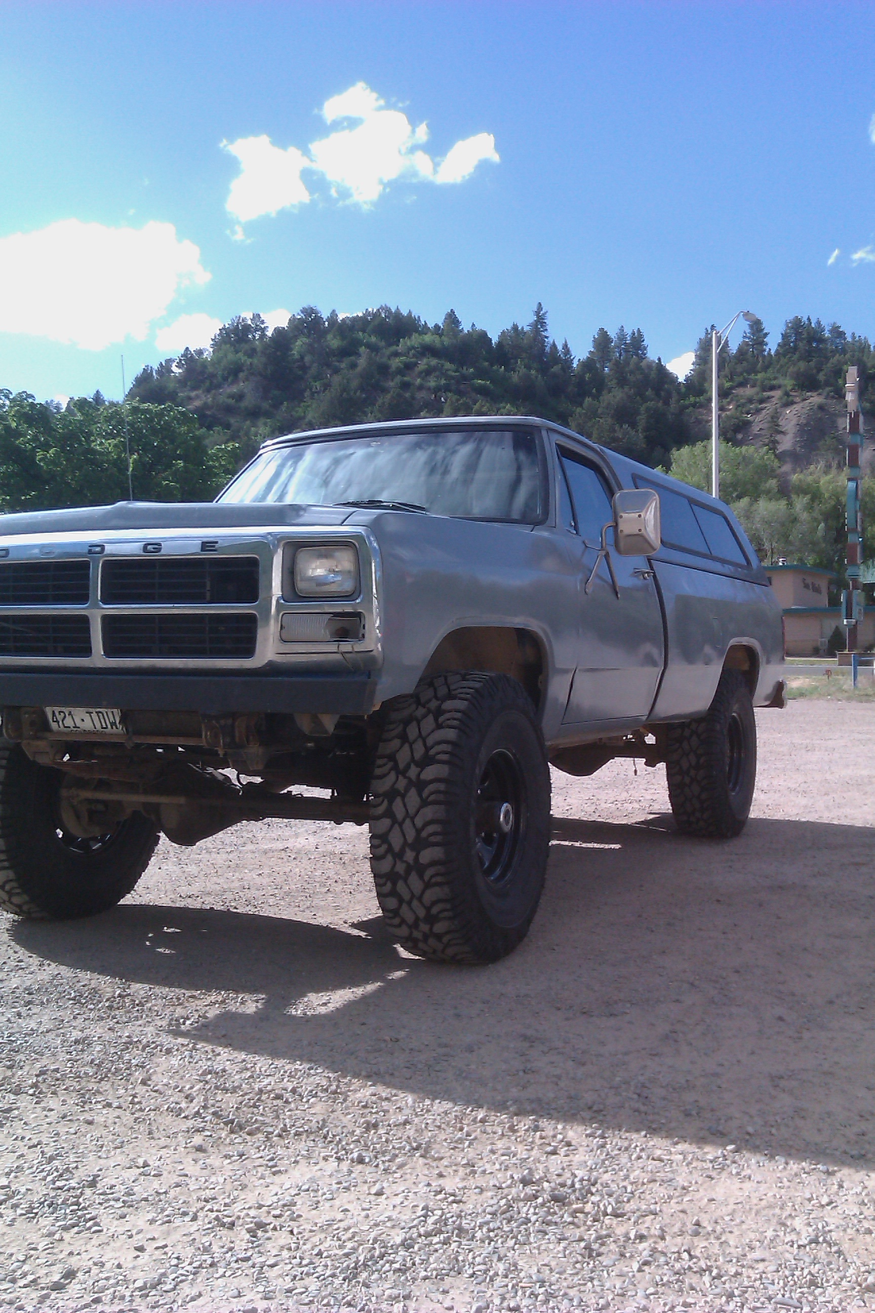

My truck....
38.5x13.5x17's Pitbull maddog radials on 17x9" steel wheels with 5" backspacing ( 38"+ tall on the truck at 45psi ), leveling springs in front ( approx 2" lift ), stock rear no lift. Fenders are sectioned/stretched 8" in front and 6" in the rear.

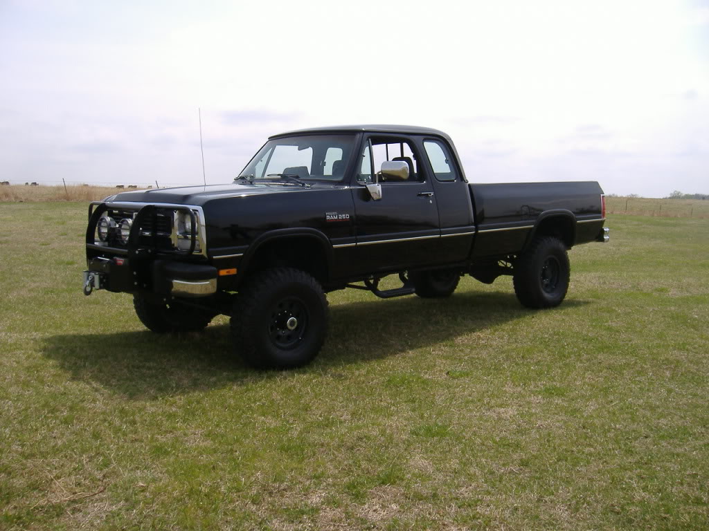

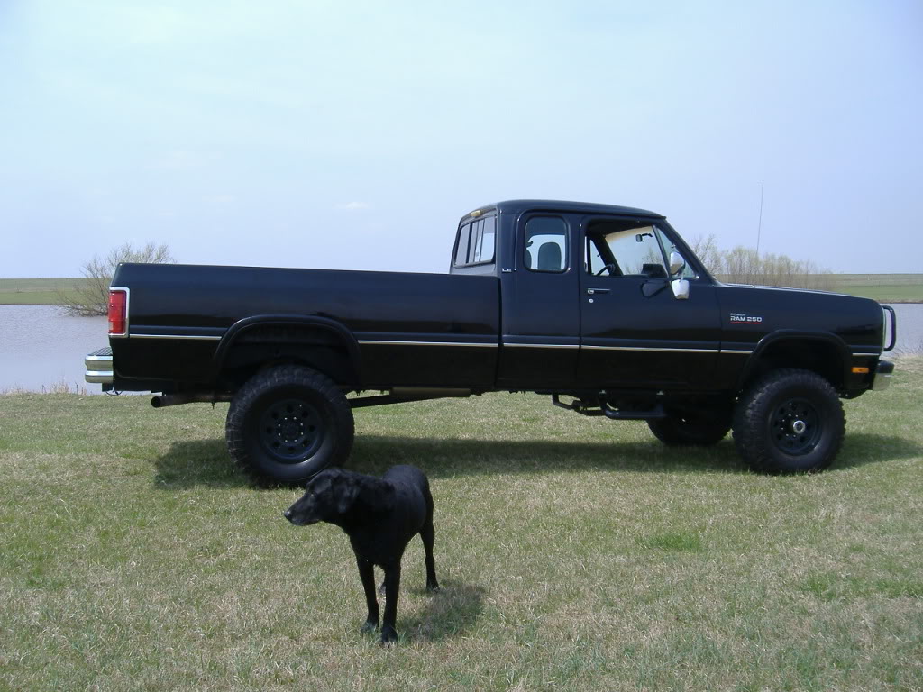

315's with a 6" lift.

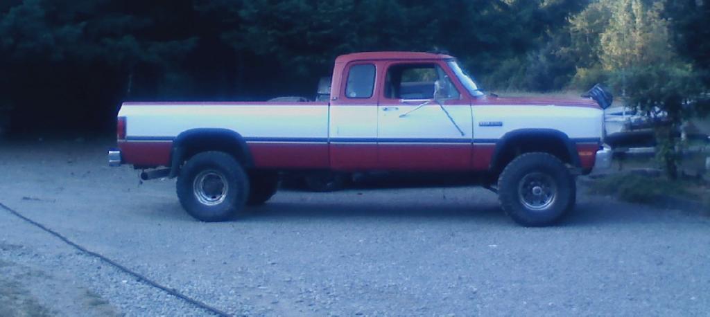

35s with 2" drop hangers and 4" drop shackles in front with stock springs. Rear is bone stock

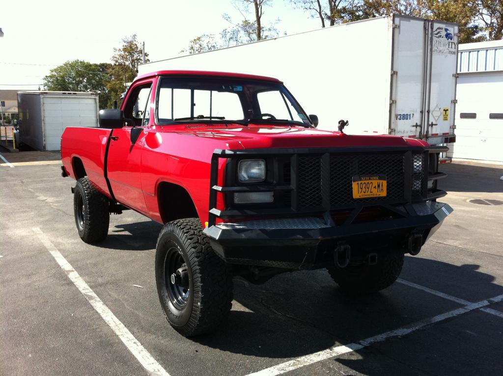

315/75 16s 4" lift

Man that truck is tasty....lovin' that beast of a front bumper....
Old Oct 18, 2011 | 10:11 AM
  #75
SORTIE's Avatar
Posts: 565
Likes: 10
From: METRO USA
no freakin DEER is going to ever reach that truck's coachwork, regardless of speed
