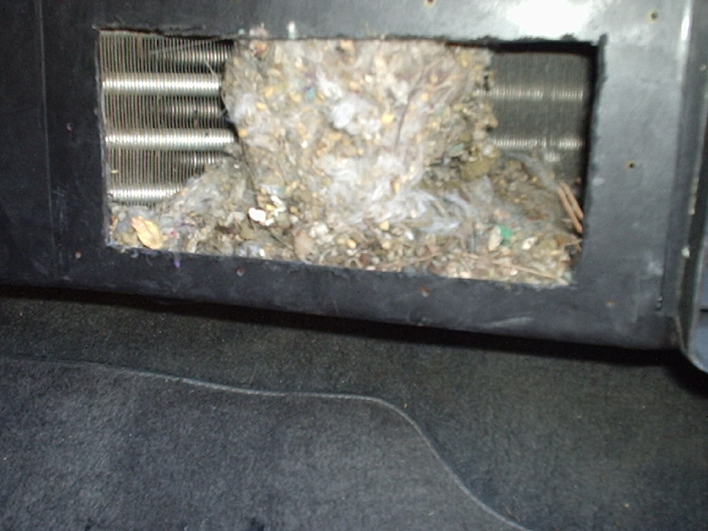

Ripped into the ducting...........
Earlier today I got around to tackling my smelly A/C problem. I made a really nice looking "access panel" and used a dremel with small cutting wheel to make an access hole in front of the EVAP Coil. Whoah Nelly!!!! I found some pretty interesting stuff piled in there! Check out my attached pic...........

Old Jul 16, 2007 | 02:17 PM
KB440's Avatar
Posts: 112
From: Ohio 45054
Now that's a nice collection
Old Jul 16, 2007 | 02:42 PM
Ace's Avatar
Ace
Posts: 3,421
From: Colorado
That looks like mice doin' that.
Old Jul 16, 2007 | 02:50 PM
Firstgenfanatic's Avatar
Posts: 676
From: Port Orchard, WA
When I first saw this mess I thought it was where a mouse had made a nest. I did not find any evidence of mice droppings at all. Most of the stuff I found was dog hair, lint, dust *****, pine needles, dirt, sun flower seeds, and little pieces of foam. I cleaned everything out really good and sprayed disinfectant cleaner all around. I also sprayed lysol on the various exiting ducts. Hopefully this cures the bad smell when my A/C is operating.
Old Jul 16, 2007 | 04:57 PM
leper's Avatar
Posts: 428
From: Dallas Baby!!!!
Good job, I think you have found the source!
Old Jul 16, 2007 | 06:58 PM
wannadiesel's Avatar
Posts: 22,594
From: New Holland, PA
Looks like half the dog was in the heater box!
