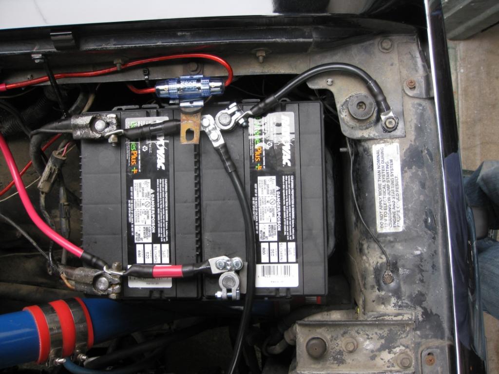

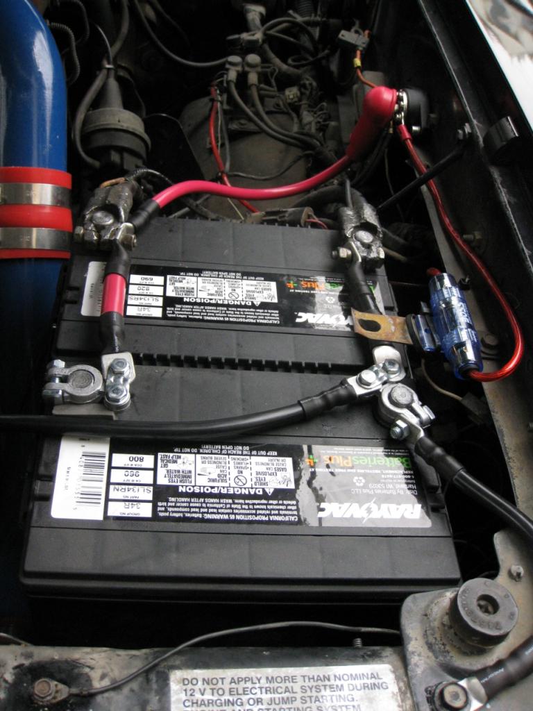

Below are some pictures of my duals.
I was having a really hard time finding a Group31 battery with the correct amount of CCA. While Napa listed that high capacity CCA battery when I ordered it and went to pick it up it was not the same one.
Same part # not the same battery.
I ended going the dual route with 2 less expensive batteries.
My logic being that if they died on me while I was traveling I could buy 2 batteries that would work at a gas station or Wallmart and make it work.
Good luck finding a 1000cca on the shelf at the Kum-N-Go.
