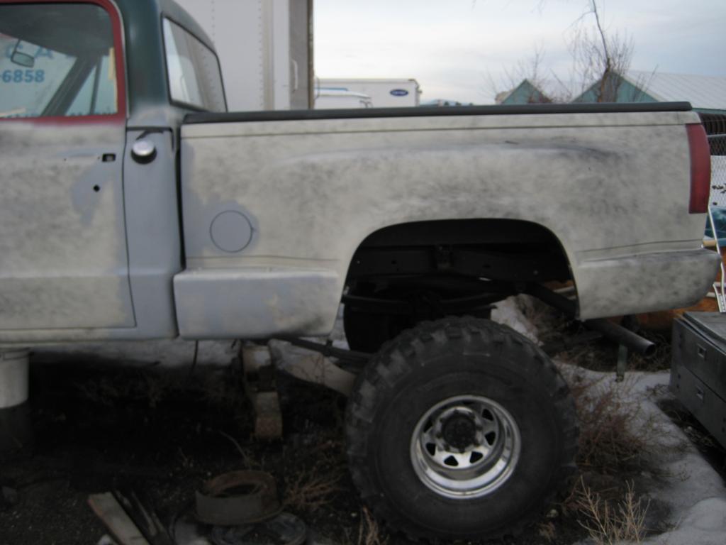

deavers are a brand and thats the route to go if your not too mechanically inclined.
if you are ambitious
do a 64" leaf swap with shackle reversal and air bags with a traction bar or trangulated 4 link with coils and air bags. would make these trucks ride like a desert racer
i did it in my chevy and it rod like a car...but you get HUGE axle wrap without a traction bar
