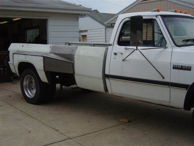

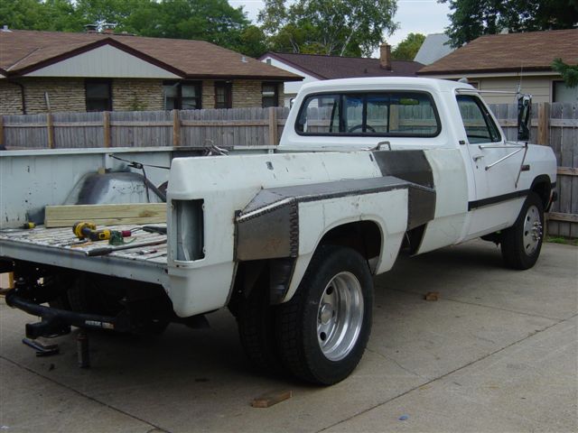

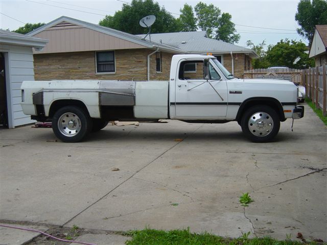

I've been working on mine a bit lately. I know alot of you will get down on me about the fenders... Being non traditional and all, but it's mine and I'm non traditional!!! Really it fits good now and I'm getting ready for bodywork/paint. The open gaps on the lower sections are going to have stainless steel steps/ inset running boards. Partially because I want a sturdy frame mounted "fender bash gaurd", but also because I could not figure out a good way to transition the fenders into the box with all those curves down there. Just kinda hiding my faults in plain sight.

I'm diggin what you've done! I really like those fenders you made too!! That's gonna be a sharp, unique looking truck! I'm still debating on whether to cut mine and section in a piece from another bed but that all depends on if I can find another one to use. Ever since I saw your truck in the first stage of the swap, I've had that same idea in my head. Did you fabricate panels to fill the gap in the bed after you cut it?

Yeah, all the parts were fabbed. the floor was the worst part with all those ribs. I'm taking it to LINE-X to cover up some of the slop of putting it back together. I'm also adding heavy plates in the corners of the floor to mount some flush mount "D" rings for tying things down in the bed.
