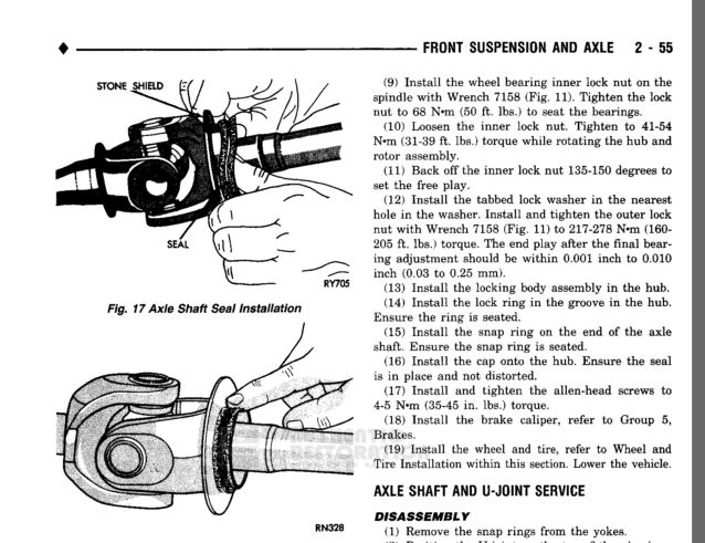

Well, I'll be a monkey's uncle.
By your original description, I thought you were working on the rear axle. Now I realized you're working on the front hubs. your explanation led me to believe you were working on your rear axle that originally came with the nylock nut on it. The procedures for the front are different than what I stated above, so.... scratch that info I provided previously.
See attached.
