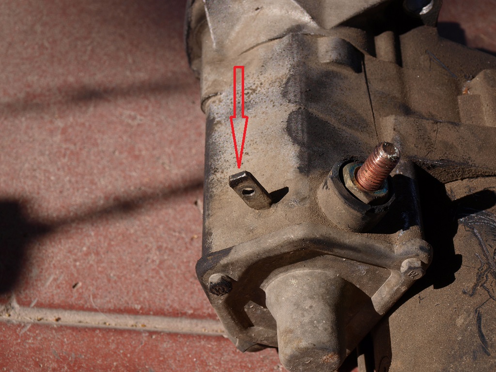

Well, I got the original starter back in it today and all I can say is: Holy Moley!!! I had no idea how much the other starter was dragging. It is a good thing that the truck always starts in a half a crank. It now spins so fast that the engine can't start on the first crank, because the starter is already on crank 5, it's awesome. The 2 starters look very similar, but if you look close, you can see subtle differences in the bosses. The other difference is the connector on the aftermarket starter is kind of a spade with a philips head screw to connect the wire, where the original has a threaded stud for a terminal and a small nut and lock washer to connect the wire. I'm just going to have them do a regular rebuild on the aftermarket one and it can live in my tool box...Mark
Attached Thumbnails Resurrected Starter-2-starters.jpg   Resurrected Starter-terminal.jpg
