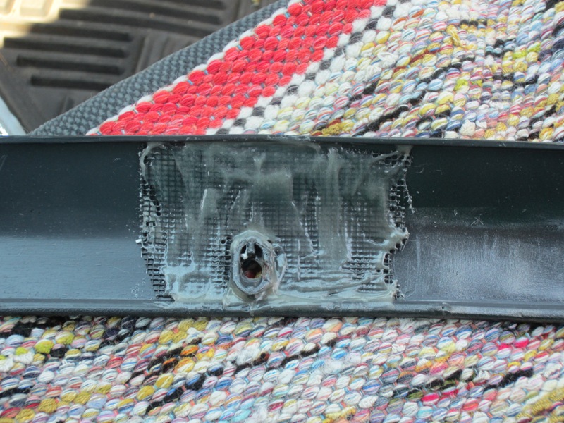

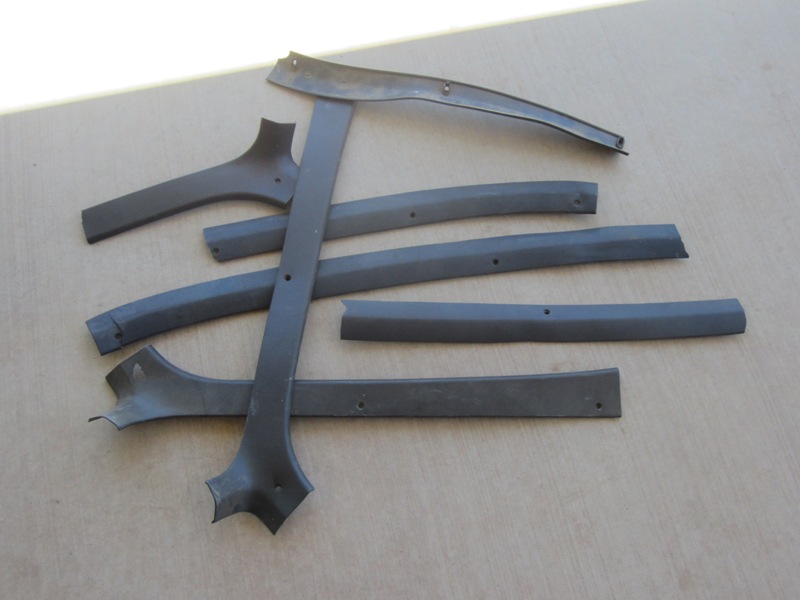

The first picture is of the old trim. There are 6 pieces of trim laying horizontal. No's 1 through 6 from the bottom up.
Pictures 2 and 3 are front and back of the finished joint between old pieces 3 and 4.

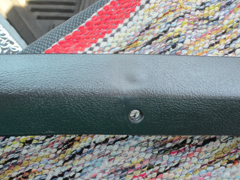

Picture 4 is the finished joint of repaired pieces 1 and 3 on the A pillar. In the old picture these two non-repaired ends happen to be adjacent to each other.

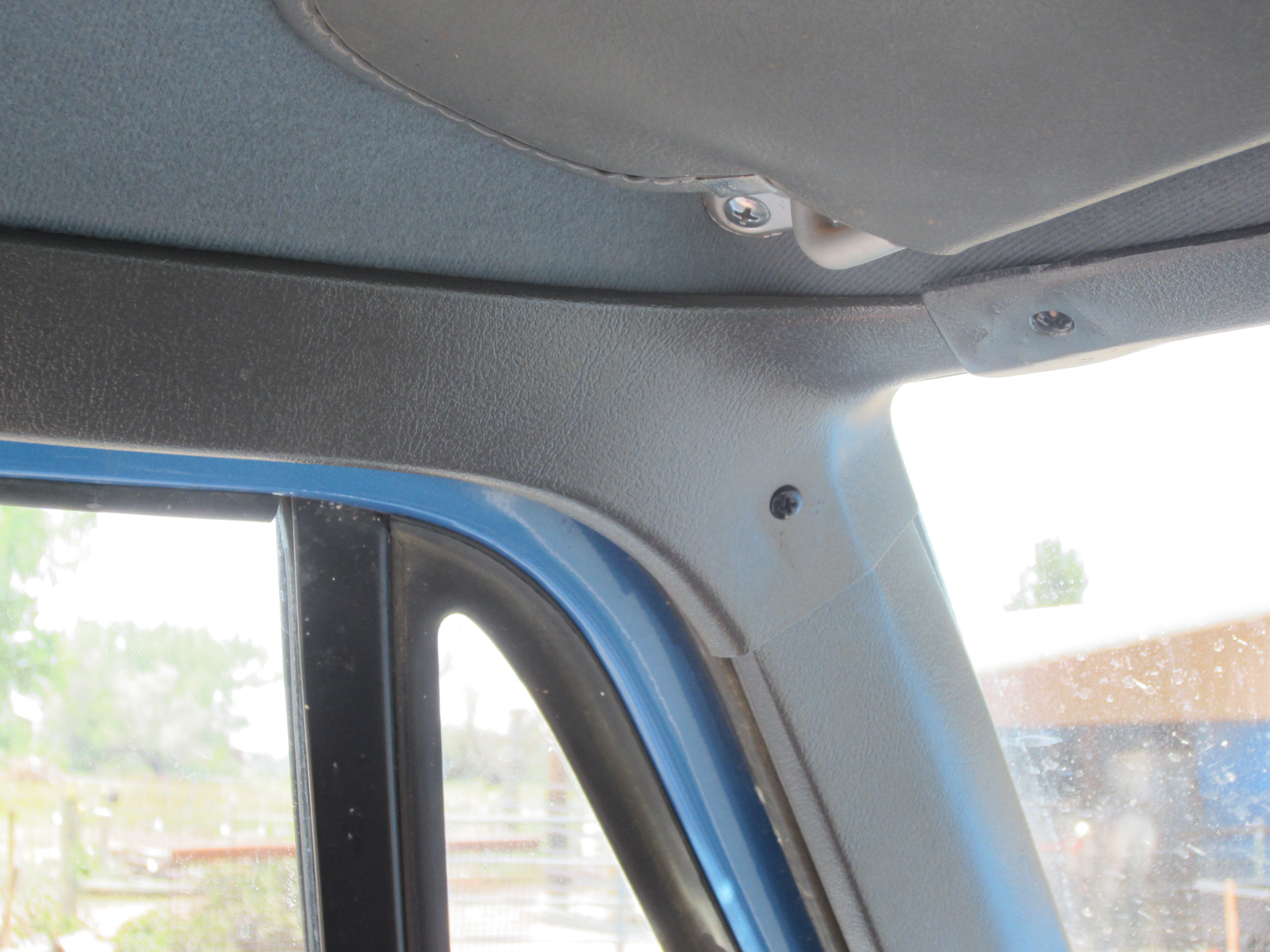

Picture 5 is the right side of old piece 3 after joining and what heat gun adjusting I could do. It looks better in the pickup than in the picture. The repair joint shown in picture 3 is shown here at the left screw
