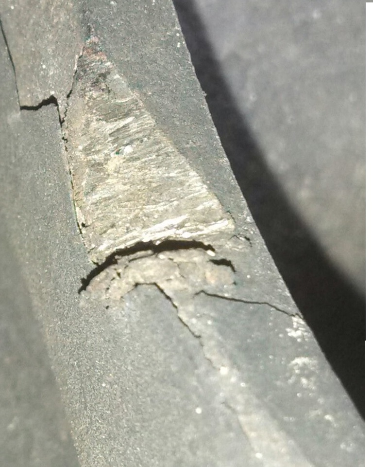

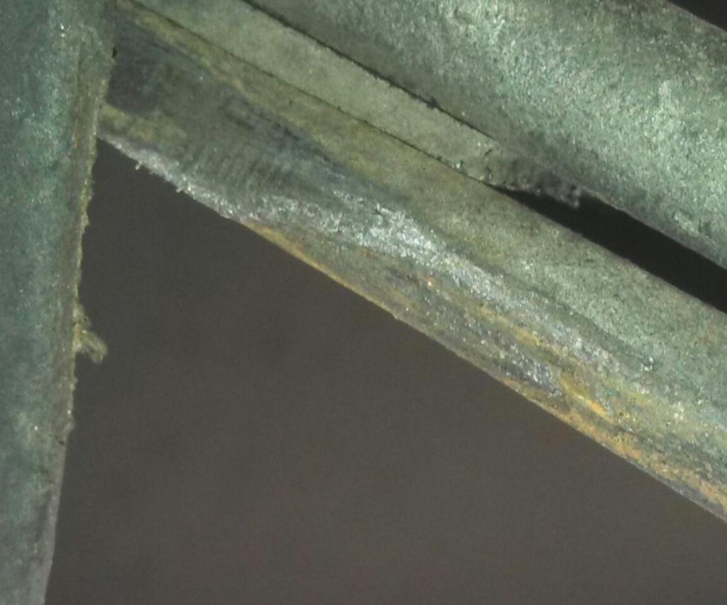

installed sky jacker lift kit in spring eliminated factory blocks , finally get new rims and tires on get alignment done .now it wants to wonder every where feels like axles our ging to come out from under truck when cornering found rear leaf springs are rubbing hangers.have bearings at all 4 corners and sway bar bushings to replace yet . what's causing how do I fix , springs to short?

We need better pics, i cannot tell what those pics are of and where?

sorry guys will try to get better pics later one on left is of inside of leaf spring just before rear shackle . right one is of shackle mounting bracket towards and bottom of frame
