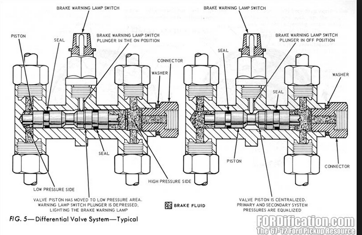

Originally Posted by boeingguy
First , I bought this truck from a barn sitting for five years.the trans an rear end needed rebuilding , which I did. while I had the rear end out I also did the disc mod on rear. after 4 months an everything back together, I don't get much fluid out of rear calipers. bleed repeatedly, got some better but not much (spongy pedal). so after reading a lot on here, I bypassed the RWAL an removed it. bleed again , still very spongy. since it was a very old MC and sat for 5 yrs I replaced it, with orellys reman(all that's available). minor improvement not much (very spongy). if you pump it 4 or 5 times rapidly you get a good half pedal, but leaks down. so is MC bad or combination valve? can I bypass combination valve altogether with 4 wheel disc? I have no idea how brakes worked prior to sitting up 5 yrs
I you are just bleeding the rear the "combination valve" is probably moved to the rear and is restricting the line.
If that is the case Try bleeding the front. You should only need to do one.
This should center the piston in the valve. I ha a old chevy that was famous for doing the same thing.

From: North carolina
Bled again , I believe I got combo valve centered,I got a good pedal not running but same ol story once driving
