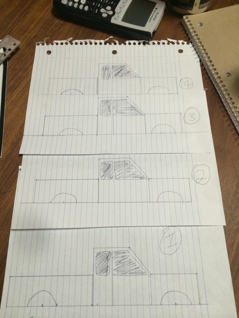

This past week while underway I decided I would cut the bed this weekend; but how and where? Theres lots of different ways. A factory sb is -16" in front of wheel well and -4" behind wheel well. you also need to add 3" to the wheel base to be proper. I tossed around the idea of making a 7' bed but why add 6" of frame etc and not just do a stretch for lb…. so I made the decision to remove 18" from the front of the bed; this way all my mounts, fuel fill, wheel well, number and cab all line up properly.
*note: I already planned and realize I am 2" of factory sb so caps and what not will not work.
also Im not a huge fan of factory ccsb trucks or conversions as they seem to be to front heavy. To me the way I cut I now have 4" more inches behind the axle than intront and this fools the eye making the bed seem longer and the truck less front heavy.
on to pics…
different designs inches converted to mm for scale portion ref. 4 is factor ccsb 1 is factory cclb 2 is the 7' bed I really wanted and 3 is what I ultimately went with.

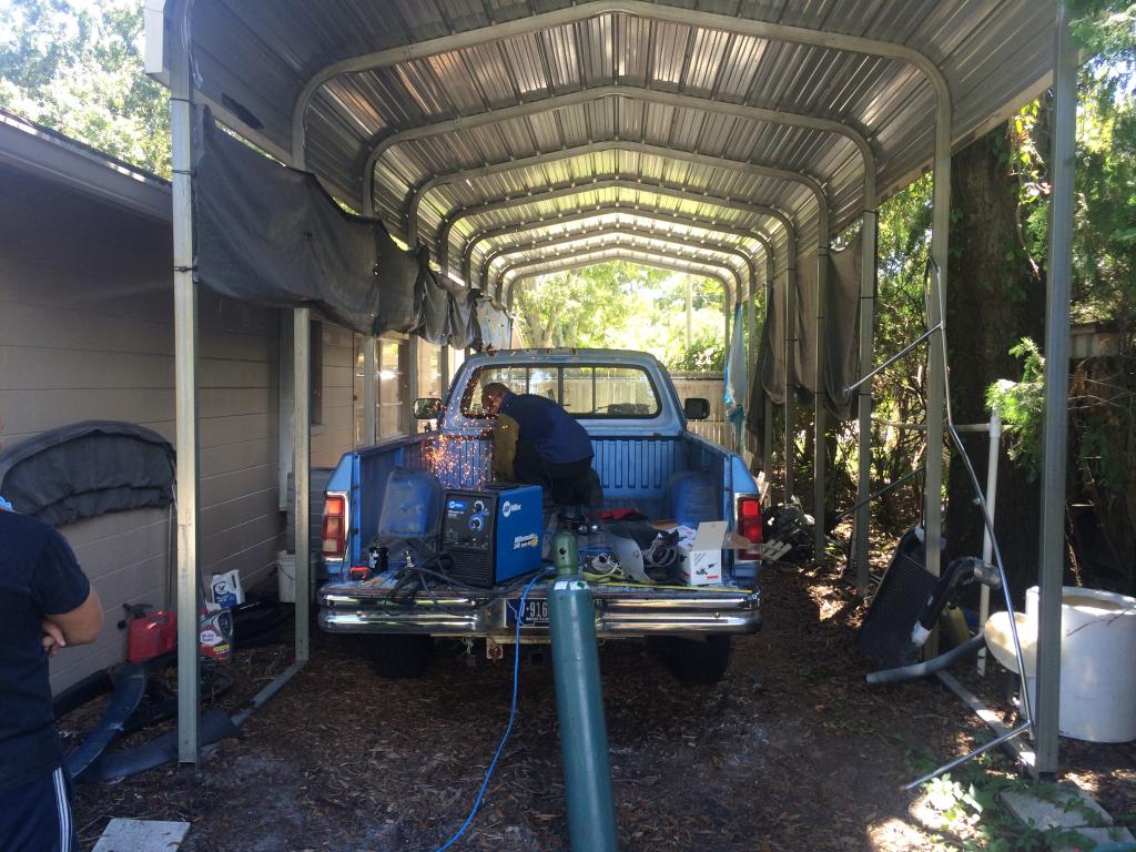

and then… sparks flew!

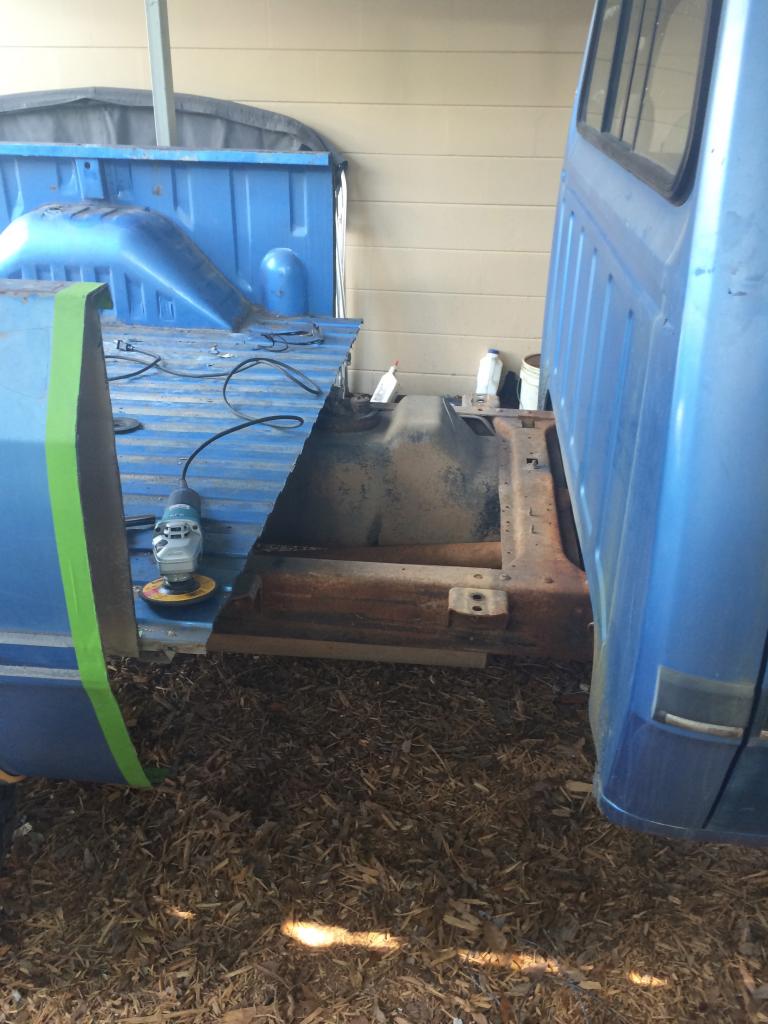

front off… note the 3" stagger in bed side and the bottom… this was done so I missed the second bed crossmember/mount and also didn't cut into my front bed pocket.
getting ready to grind off the front bed mounts on the frame
bed front; note the corners aren't fully removed but the removal stage was easiest (for me) this way.

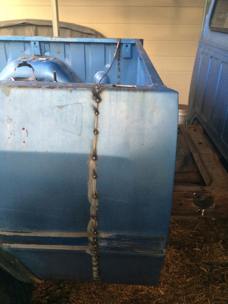

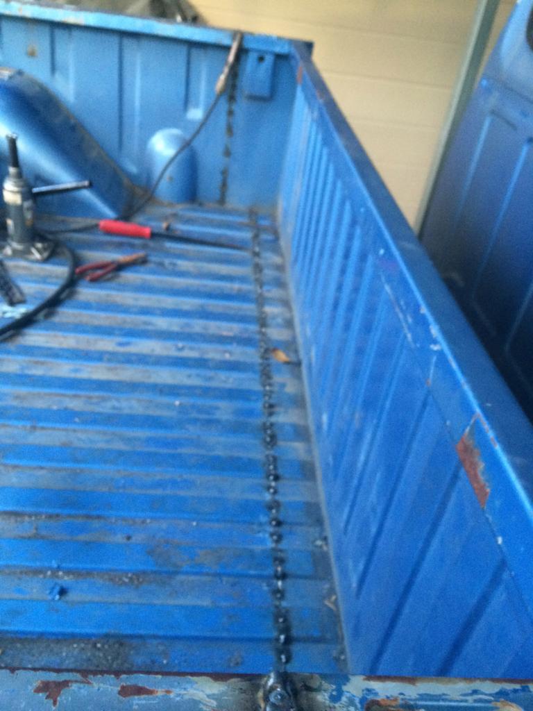

tacked up
all in a days work. got more welding complete (almost done) just don't have the pics to show. yes the bottom is jogged slightly but I'm not to concerned as its getting a spray in liner and that should make that minor detail well.

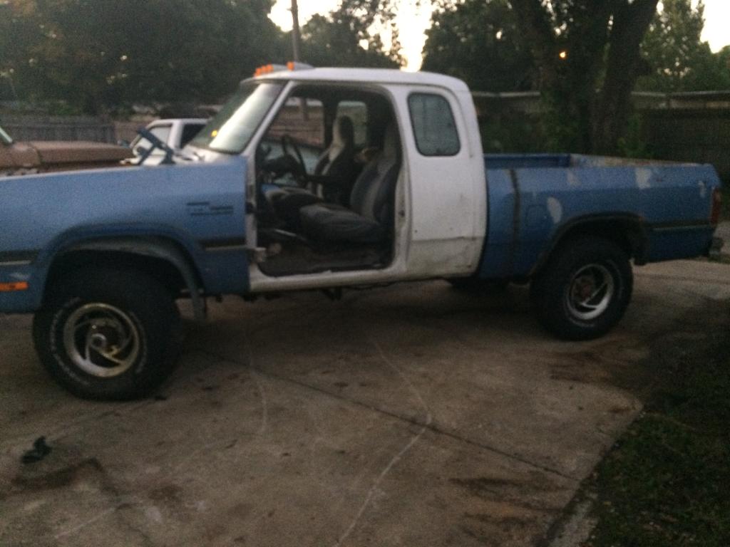

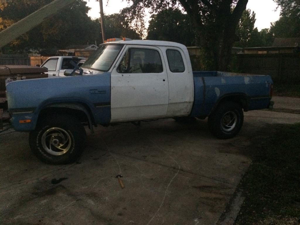

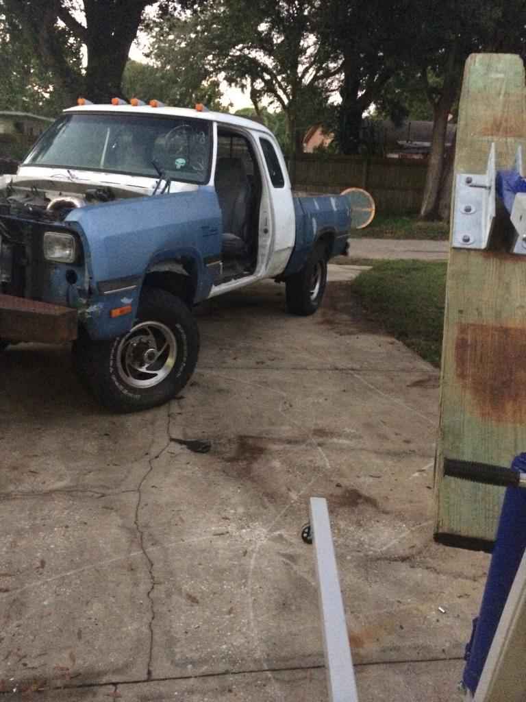

did a little work today; been running around for the past 3 weeks. after setting the cab on (cabs on 2" blocks, everything else is at stock height right now) I've determined a few things: 2" of lift is bare min. and the fuel tank is the only clearance issue. currently Im liking the thoughts of simply dropping my tank 2" or at the very worst situation 1" or 1.5 of body lift and dropping the tank appropriately (i don't want to deal with all the body lift issues… any ways i hope you guys agree, this girl looks mean!

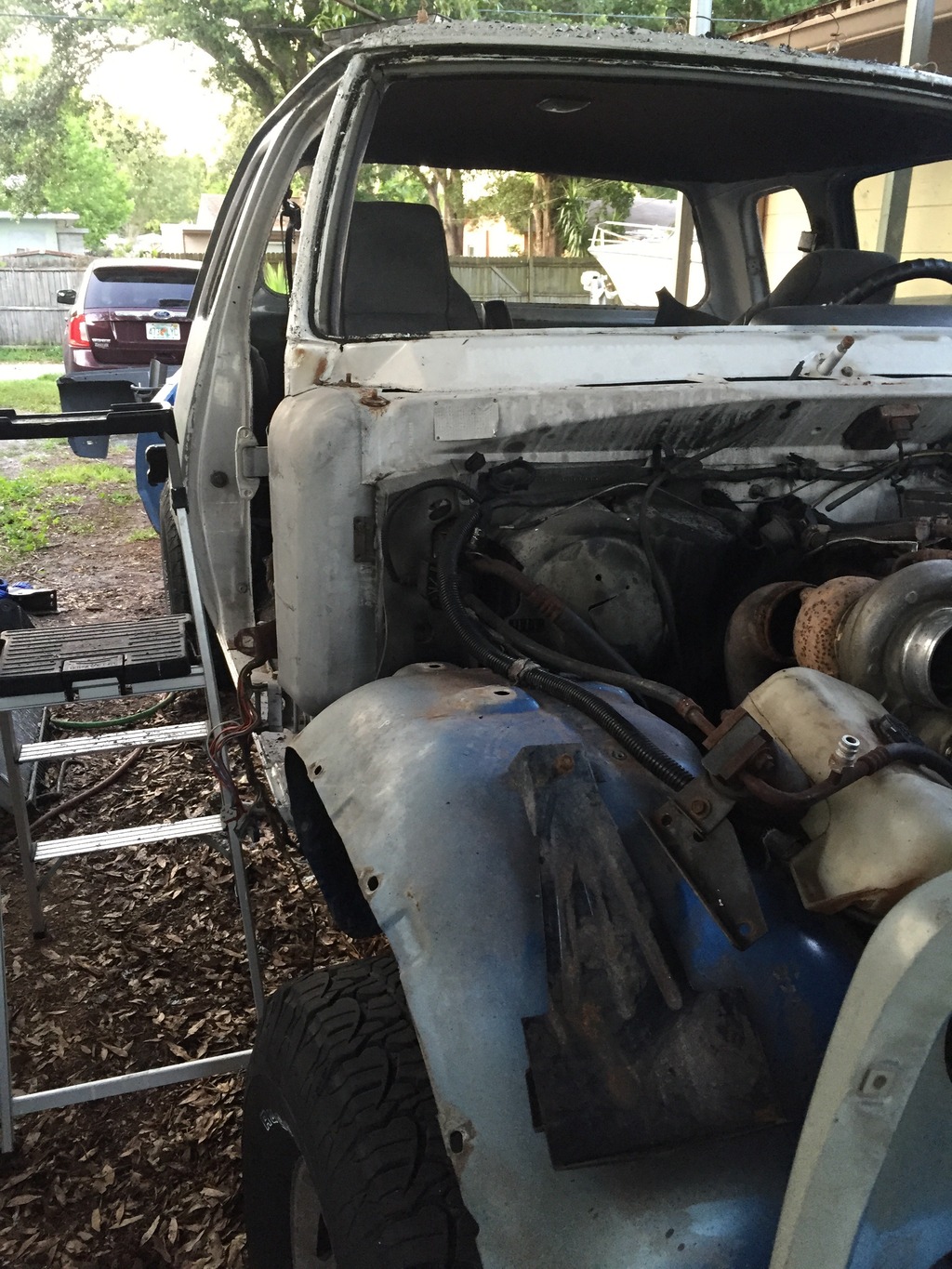

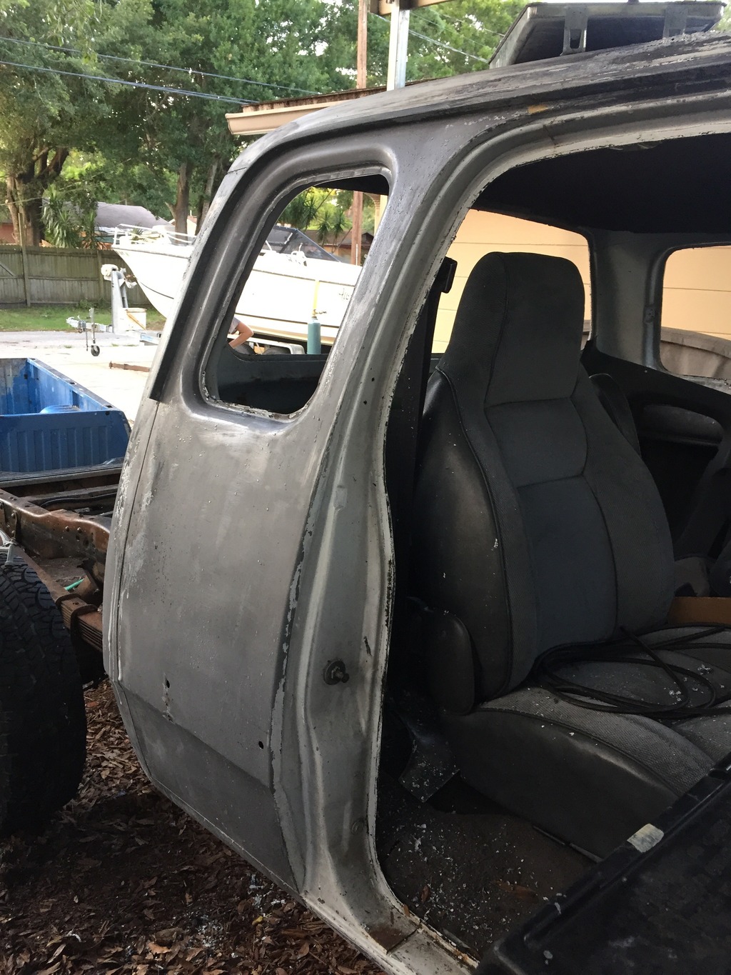

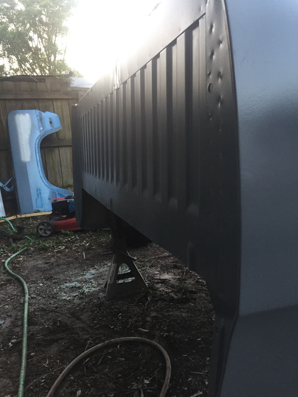

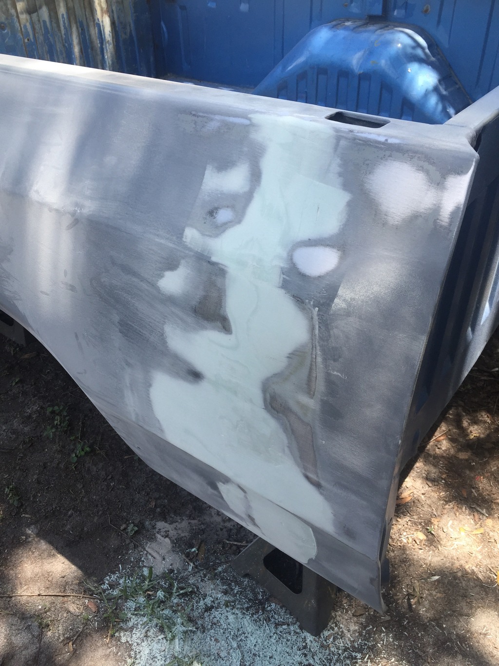

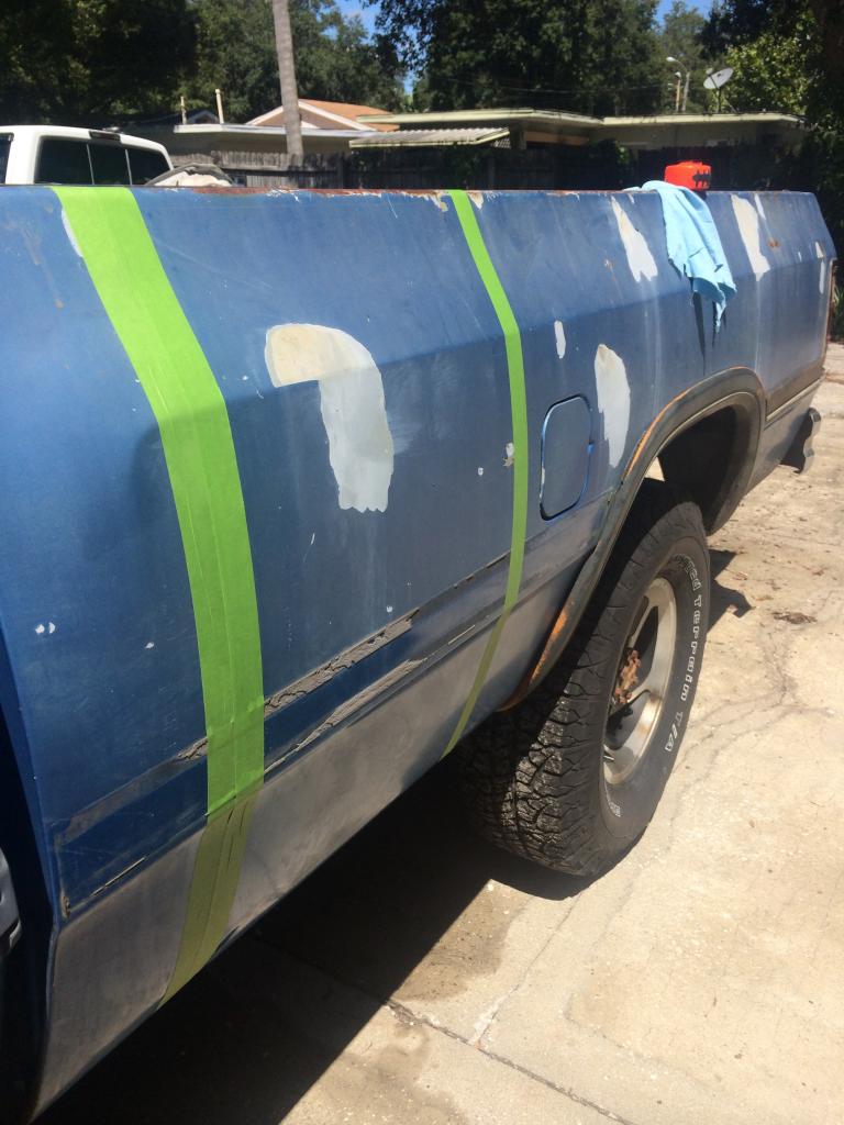

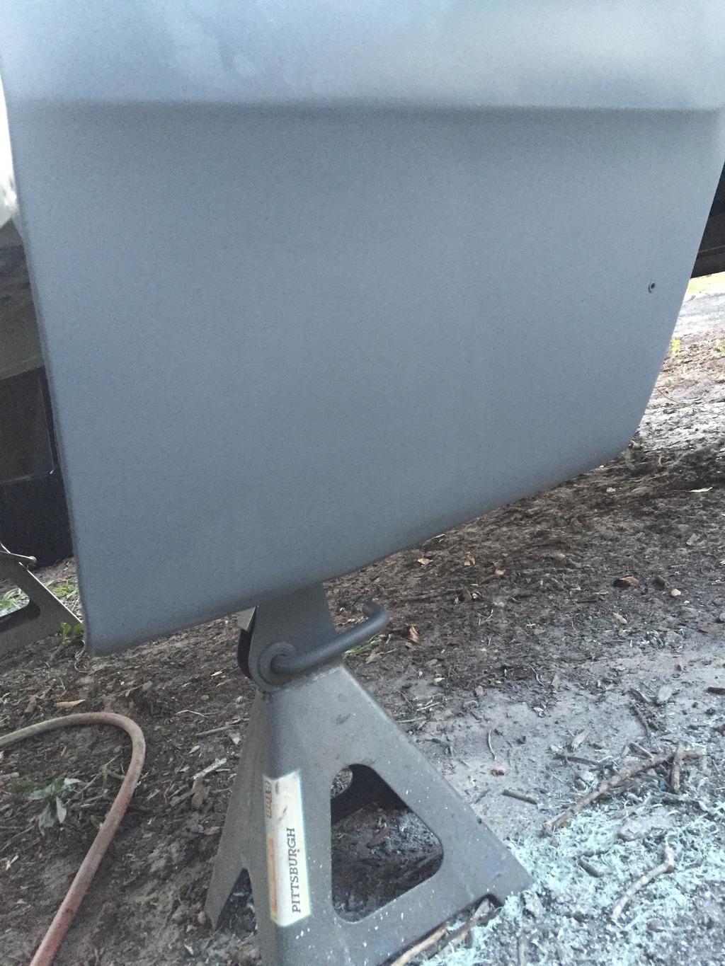

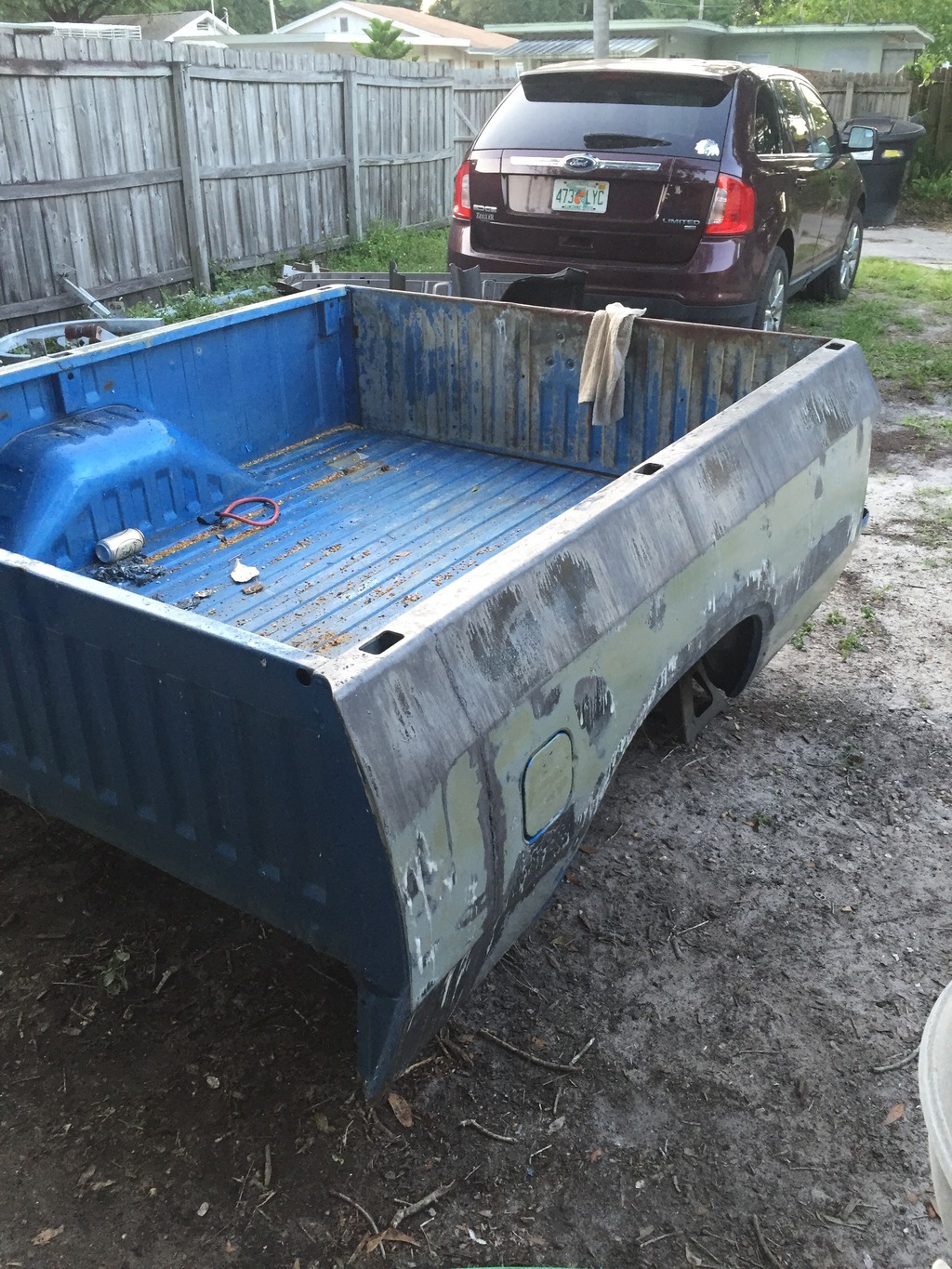

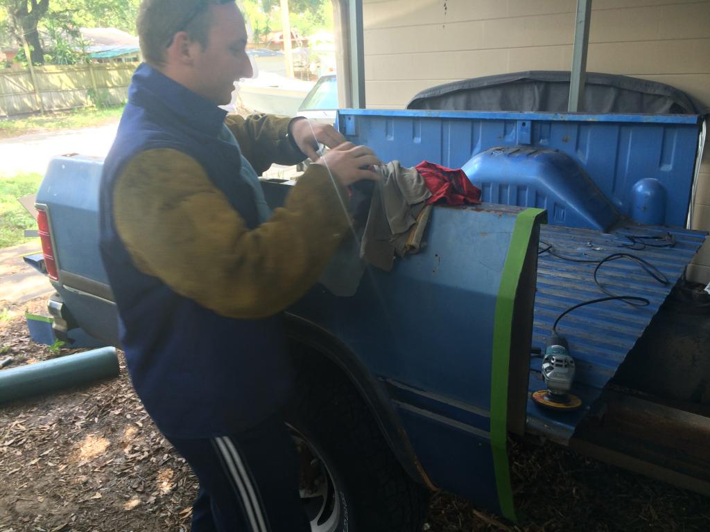

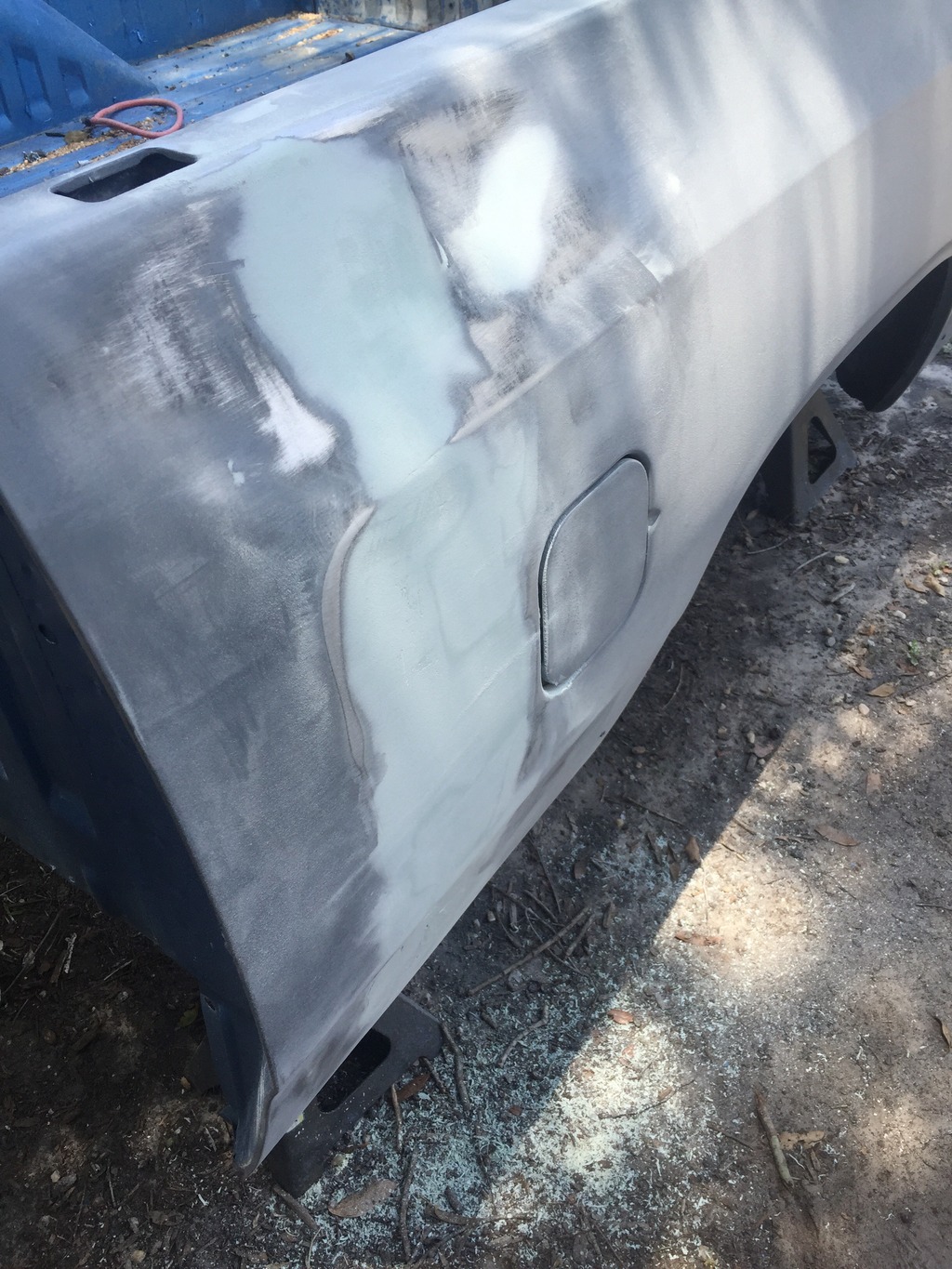

Well in preperations for the transfer to Juneau this summer I gotta get this old girl ironed out. Been driving it all hacked up for a while so getting busy with body work... Going with a dark charcoal metallic with a flat clear on top.
