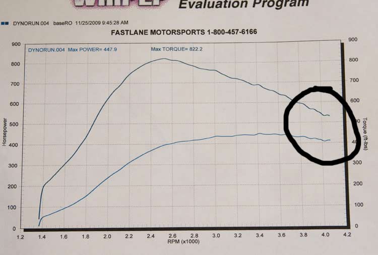

I'm at a point where one spline is too far one way or the other. I need to dial in both the at idle position as well as the full fuel postilion. It's gonna amount to a narrower throttle rotation compared to a stock or a unmolested 3200 spring.
Let me show you what I'm talking about . . .
I let off the throttle just after 4000rpms. See the upswing in both the HP & Torque?
I didn't have full fueling for that dyno run!
