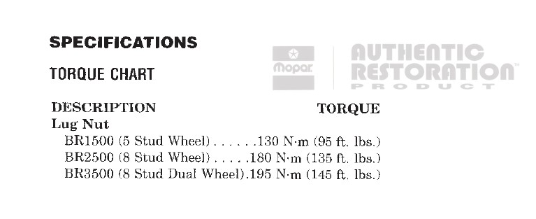

Whoa, not saying it isn't in there, but no way would I torque them to 200 Lb/Ft.
From my 97 FSM.

That 135 lb lb is for 9/16 studs as well
Don't have a picture but 95-105 seems a standard torque for 1/2-20 studs
I've had a couple of FSMs over the years with pretty big mistakes...like this...mostly on torque values

Well, if you're showing your FSM, I'm showing mine....
Every truck I've ever owned had a 90-135 Ft LB torque spec, unless they were with Alum wheels, which ran from 76 to 83 Ft lbs.
My wife's corvette that she had was the only alum rimmed vehicle I had that specified a 100 ft lb torque.
Torque specs are based upon fastener or lug size (diameter), and 200 ft lbs is way over the spec for any 1/2" fastener, as far as I know..... but what do I know ? I haven't slept in a holiday inn express lately, so I guess I'm really not qualified to say much of anything anymore.
But... it is in black and white, or I saw it on the internet, so it must be true..

Yup, definitely a typo, all the generic torque charts show much lower values than 200. At least it is easy to get the broken lug out...Mark
