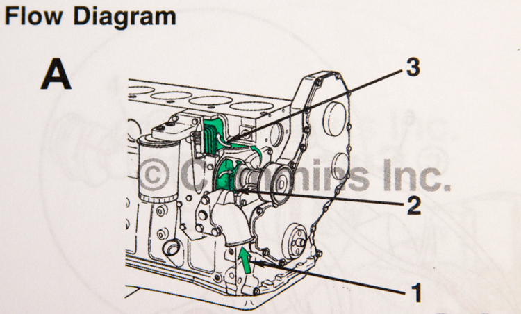

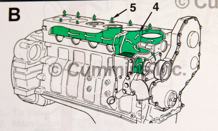

From what I'm seeing in the Cummins manual, that hole is suppose to be there as it is in fact the waterpump's outlet and it plays into the cylinder jacket by design.
Give me a few minutes to post pics.
Old Nov 12, 2009 | 08:28 PM
  #32
BC847's Avatar
1st Generation Admin
Posts: 4,601
Likes: 118
From: Buies Creek, NC
See item no.3 in Flow Diagram A . . . . .
Views A and B
1. Coolant Inlet
2. Pump Impeller
3. Coolant Flow Past Lubricating Oil Cooler
4. Coolant Flow Past Cylinders
5. Coolant Flow To Cylinder Head
Views C and D
1. Coolant Flow From Cylinder Head
2. Coolant Flow to Thermostat Housing
3. Coolant Flow past injector
4. Thermostat
5. Coolant Bypass Passage
6. Coolant Flow to Water Pump Inlet
7. Coolant Bypass Closed
8. Coolant Flow Back to Radiator

if it aint broke DONT FIX IT!
Old Nov 13, 2009 | 06:34 PM
  #40
Riflemanusmc's Avatar
Registered user
Joined: May 2008
Posts: 1,520
Leave it. Keeps the engine from overheating before the T stat opens. Normal bypass. All 4/6BT's have them.

Smoothing out the rough edges won't hurt. That is were cracks usually start.
