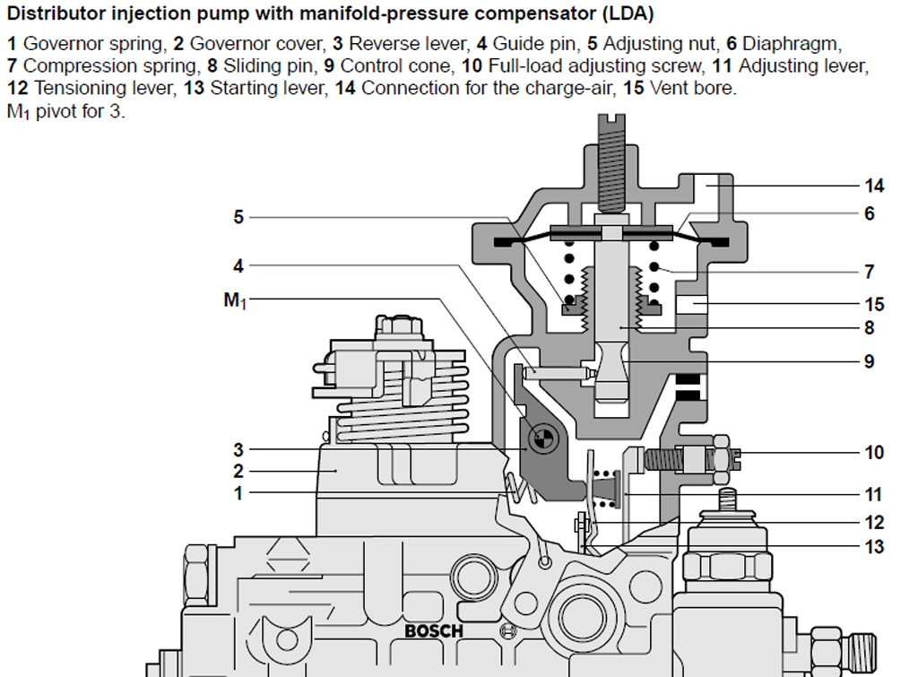

I've always found images of what I'm messing with were of help . . . .
Old Jun 18, 2013 | 04:42 PM

The only thing that would keep the cone from coming out is a damaged guide pin.(4) That's what you need to deal with.
Perhaps backing the full power screw out will relieve some of the tension on it.

If the Guide-Pin's seal is in good working order, there's a good chance condensation has gotten in there and cause corrosion of the Control-Cone (we call it the fuel-pin) and/or it's associated bore of the aluminum-alloy housing. Either of which may have a good grip on things.
You might consider removing the rubber diaphragm and associated washers so as to expose more of the control-cone for the purpose of getting a forceful grip on it with the appropriate tool.

The image you posted was of great help to me. I'm going to take your advice of removing the diaphragm to get better access of the fuel pin. I'll get it in the shop tomorrow night and let y'all know how it works out!
