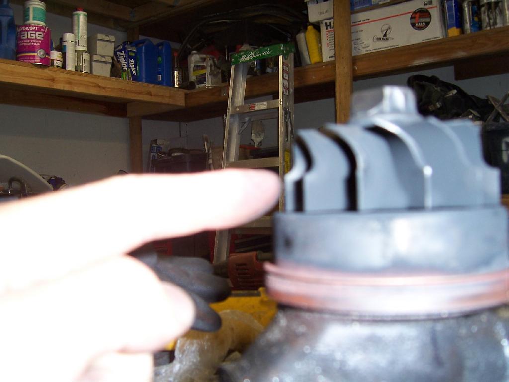

I finally got the exhaust housing off and found the bell housing thing behind the fins is loose. Turbo seemed to work fine before removal so i don't know if this is always loose and is tightend down by the houseing or not.

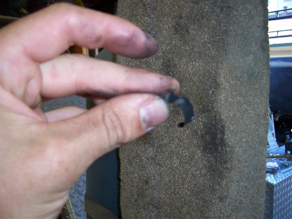

I also found a piece of metal while doing this poject which is held in one of the pictures.
It also seems like the bottom of a couple of the fins are smaller than the others. (picture # 3) Is this normal or should i order a new piece. If i can run it i will order a 60mm setup and get a new exhoust turbine alos and pull the whole setup and put new pieces on.
Thanks a lot for any help.

Yes it is supposed to be loose. It is called a heat shield. It insulates the hot exhaust gas from the piston ring oil seal and bearing on that side of the turbo.When you put the turbine housing back on, it gets clamped down with the shoulder that is inside the housing.

yes and it tightens up when the new housing is installed but clean it best you can, thats what i do anyway get rid of the soot and rust.
now the other part i have no idea what it is
this pics shows every peace i found in my H1c
http://i289.photobucket.com/albums/l...s/DSCF3229.jpg
maybe it fell off the bench?
