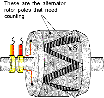

What does that equate to in poles though? Seems like they are usually even numbers (4,8,12, etc.) I think the poles regulate the number of pulses/revolution put out by the alternator. Seems like most of the alternator pulse tachs have a switch on the back for the number of poles.

See picture for more info.

Thanks! Any way to count them without disassembling the alternator?

You might be able to view them through a cooling fin port or something, not sure though. I dont have a 1st gen anymore or i would look for you.

From the photos online it looks like 10 poles.
