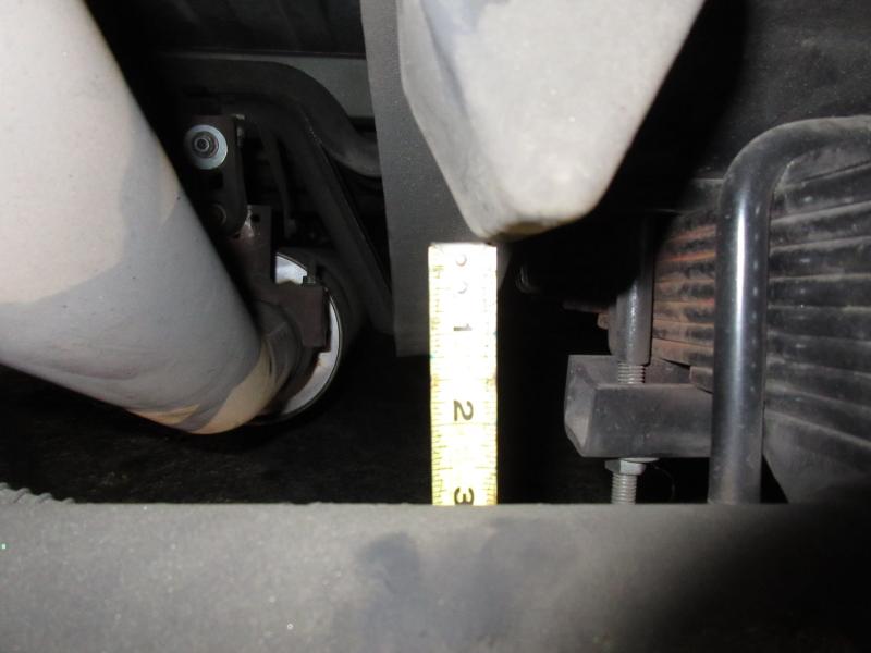

This is a view of how much suspension travel that I had in the rear, interestingly though I when I hit any dip in the road it would be like I was hitting bottom, and the truck would bounce like I was hitting my bump stops but there were no marks on the axle tube or on the bump stop until I came to realize I was hitting the internal bumpers inside my airbags,
by adjusting the air pressure I was able to eliminate the rebound.
