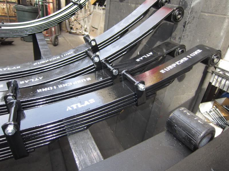

So last week I went to Atlas Spring in City of Industry http://www.atlasleafspring.com/index.html and ordered my new set of custom springs for my dually I paid him $300.00 deposit and he said he will have them in a few days.

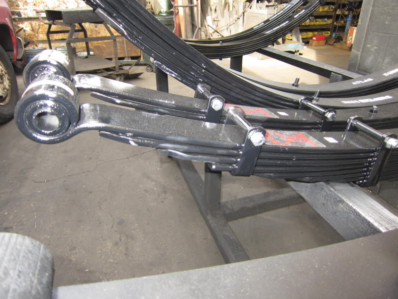

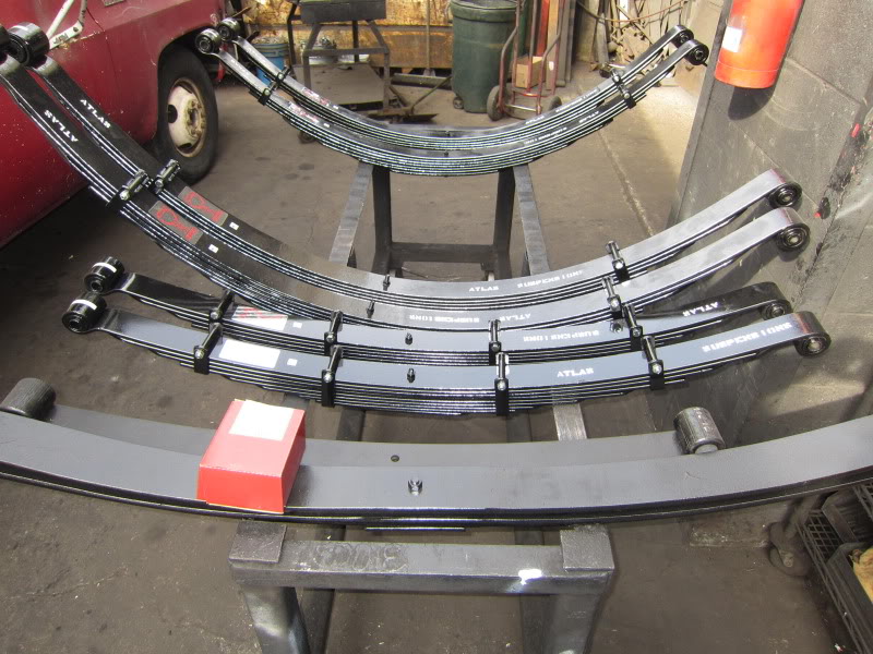

They do not order the springs from some company that mass produces them by the hundreds, each spring pack is hand built according to your individual specifications and request.
See if you can guess which ones are mine?
They are the second set from the bottom.
It is like I got my truck a Christmas present that it always wanted.
I had them build me a 9-leaf progressive "Soft Ride" spring pack, there are more thinner leaves to take the place of the thicker stout leaves.
All of the springs are made in house, from domestic spring steel, no Chinese junk.

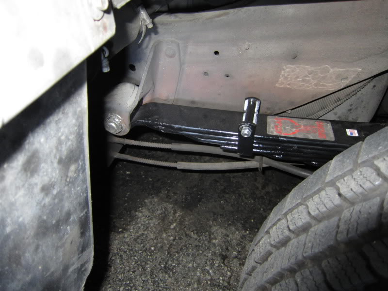

He also added 2 extra clamps to keep the pack together and each spring tip rides on an isolator.
I had them install them on the truck, it was not worth my time to have to get dirty and he told me they had a real pain trying to get the front bolts out.
I dropped it off at 11:00 A.M. and he called at 3:00 P.M. and said it was ready.

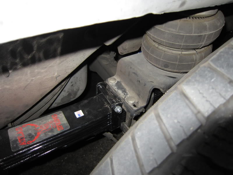

That last clamp just cleared the mount for my airbags

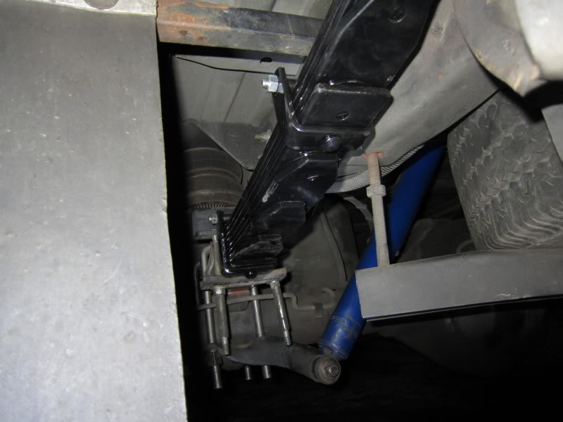

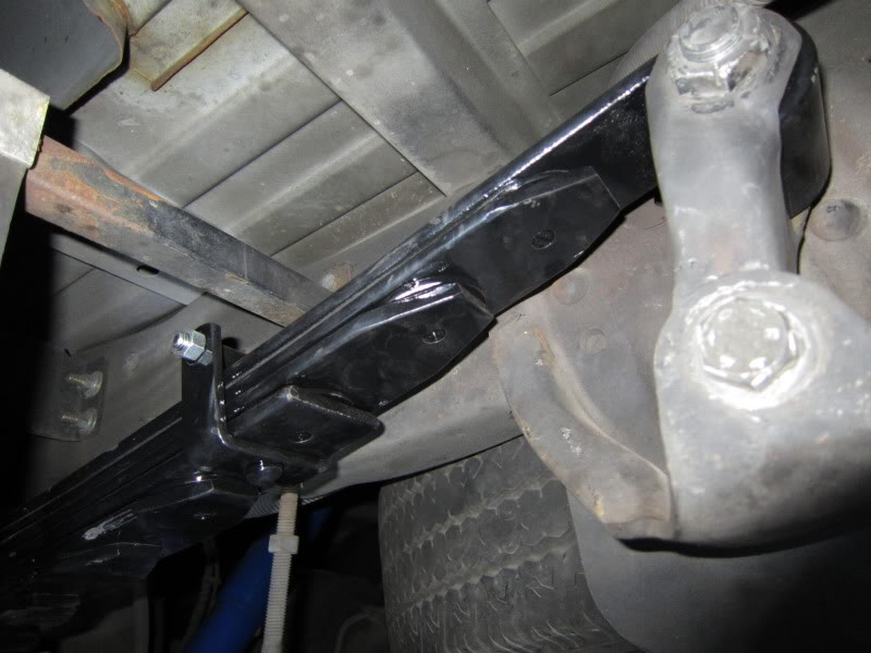

Here you can see the tip isolators and how the leaves now slide on poly instead of steel.
Also notice that there is no overload spring, with the new springs to gain a much better ride I had to sacrifice 500 pounds of total capacity but I will never miss it, my air bags will easily make up for the loss.

Also when I was unloaded my old springs from my truck, in checking their condition, other than my broken overload leaf all of the spring tip isolators I had installed were all still in near perfect working condition and had not significantly worn down, so I would still highly recommend doing this to your springs.
The only thing I am not happy about is they got the rear end 2" higher than I wanted but at my convenience they are going to pull the springs and drop them 2" it is amazing how 2" of lift in the rear can change the stability and handling that I am used to, it seems to have introduced a bit of wander in the steering.

Jim,
Those springs look High Quality.... nicer than the ones I bought out of Canada
If you left them, wouldn't they settle down ? Meaning the 2" lift would eventually work its way southward slightly ??
How will they lower them, other than reverse arching them in their press ???
What are you doing with the old springs ? Other DTR members in your area might like to buy them ....
they could say that they had a little bit of "Jim Lane" in their truck.....

Another fine addition to your truck! And a very reasonable price. I haven't been in the forums for a while, and it was a pleasant surprise to see your post right off!!
2" in the rear reduces the caster angle enough to make a noticeable reduction in the steering's return to center, but as already said, I think I might wait to see how much the springs settle in the first six months -- especially if you encourage them a little by not airing up the bags . . .

Put some weight on it and let them settle in to see where you end up as others have said.
About 25 years ago i did something similar of a spring build on all 4 corners of my 1/2 ton 74 power wagon. Used the thinner stock kept the original mains added 7 in the fronts 9 in the rears 3.5" overall lift = truck rode great and still could carry the same load as a 3/4 ton truck would without dragging it's azz.
Looks like they did a quality job with the extra clamps and sliders
It is going to be a few months before I could even get the time to return so for now I am going to let them ride but I don't think they will settle in 2 inches though, also I do not like the feel or the stance of it setting at that angle.
Until then I might add a couple of isolators under the front coils to level it out.

Jim i would tend to agree you likely won't get a full 2 inches and how much help they get from the air bags (air pressure) will be a big factor. It will take some time, after a few months you should have a good idea. What is the condition of your front coil's, if they are the original's they are tired maybe a fresh or upgrade pair up there and the rear settling into place would be the outcome you are looking for.
