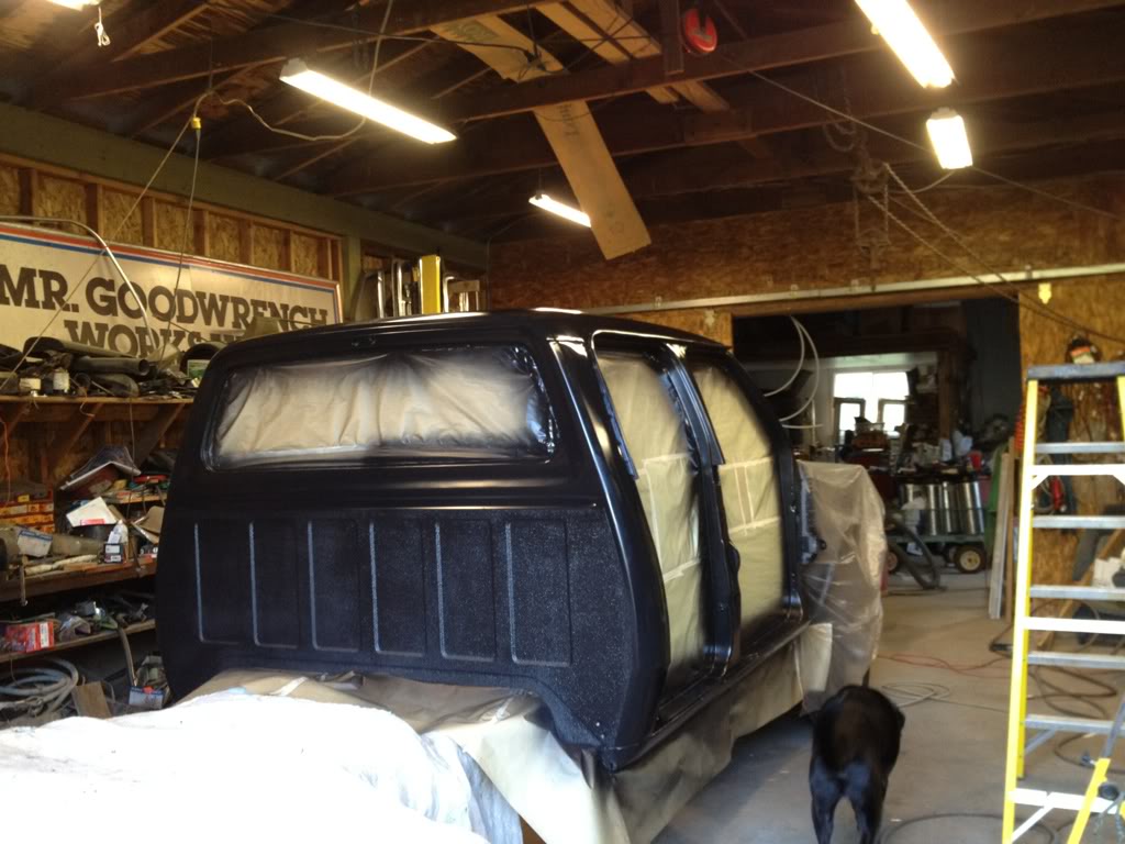

Finally, after 4 years,
Epoxy Sealer

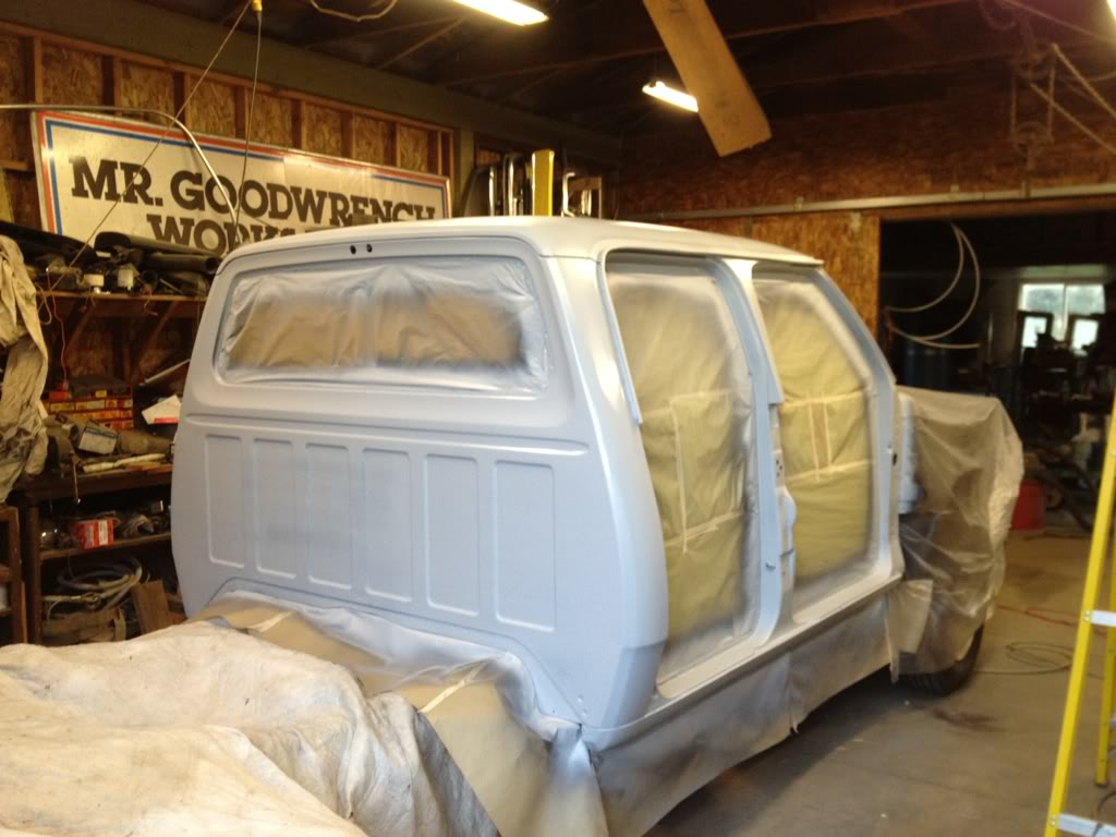

And primer

Trooper the epoxy sealer how well dose that work?

I don't know how I like the epoxy yet. The PPG folks said it would be a good base for bare metal and old paint. I originally bought it to put a quick coat of black on my 1975 shortwide because it seals out the weather. I decided to use it here thinking it will start to show when I am sanding the high build primer before I burn through. Once all the body work is done, I will seal it again with light gray epoxy before shooting color and clear.
BTW, my dog is flattered you all thought he was me as I am a magnificent specimen.
