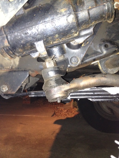

I completed my spring install and took the truck for a test drive... The steering wheel is off center by about 70 degrees and it feels lighter than normal. Also the drivers side bump stop travel is about 1/2 what the passenger side is. The steering thing is really got me wondering? Everything is tight, the lighter feel could be the new tires... Ideas???

I guess you want to see how far the steering wheel is? or is there a different picture you need to see.?

Old Jun 27, 2012 | 12:40 AM
Posts: 6,839
Yes,
The steering wheel being off is completely normal.
Differences in height may be normal, but you won't know for a hundred or so miles.
WHen I did my springs, the steering wheel spins slightly as when you increase your spring height, it alters the position of the pitman arm on the gear. Wait a few days, then get your steering wheel puller out, and re-center the wheel.
Both issues are due to the new ride height. Drive it around for a little while and let the springs mellow out for a little bit.
My truck was two different heights from side to side when I first installed the springs. After driving it around for a short period, they both were the same height ..... I brought the truck back to the spring shop without measuring the second time before I went there, and by the time I pulled into the shop, broke out my tape measure, I realized that the springs settled to their resting point, and both sides were the same.
Good thing I didn't mention that to the spring shop guys, otherwise I would have looked really silly..
