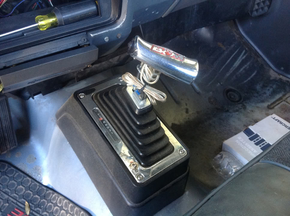

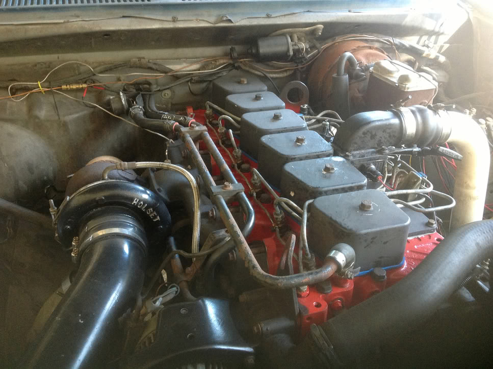

The kid claims that the truck has 5x14 DD injectors, and a 16cm housing on the stock turbo. the truck does have a cold air kit, factory intercooler, oil, egt, boost, water temp gauges, and believe it or not a B&M floor mounted shifter, which I hated at first, but its grown on me. There is no rust, being from Florida, but it appears every truck the Chrysler corporation made has donated a part to this truck. Luckily the fenders are straight, and I'm almost done painting the truck anyway. The wiring was redone in only the way a 20 year old could do it, it's sound work, with most things being put on relays, like electric fans, headlights, etc etc, but it could stand some conduit.

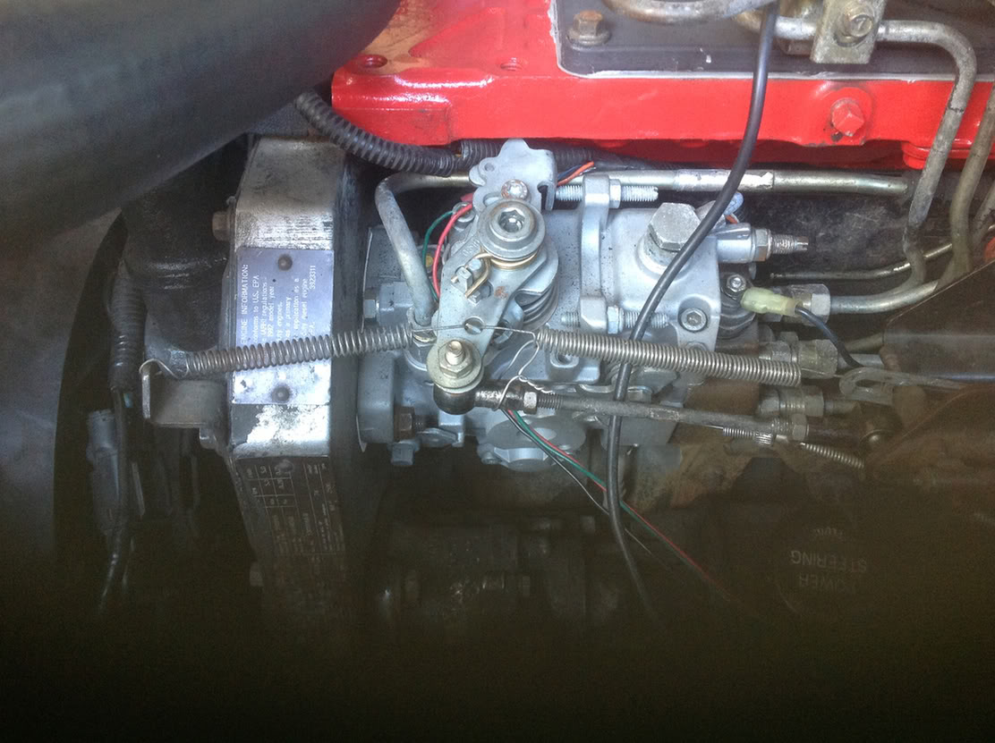

Anyways, my big mystery is the so called "agricultural" VE pump that was put on at Shiver diesel in Florida. I know nothing about these pumps. It looks like a regular VE with the AFC removed. It's new, less than 1000 miles on it, and supposedly has a 3200 spring, and I can see where they bumped the timing. Fuel has been turned up as well.

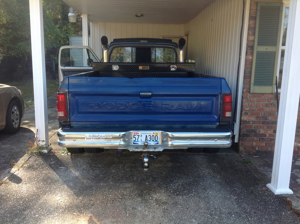

Truck also has 4 inch exhaust back to twin bed stacks too, PLUS, the kid had a hood stack all made up too, if I want to go that route.
Any info about the weird VE pump I would appreciate it, thanks guys for helping a noob out!

You already said what it was basicaly a ve without the afc if it runs good I would run it.

That pump is designed to run at a certain rpm. It's not good for the street, if it works then it works, but I'd start looking for a regular pump. Also I think I remember some of them having smaller head and rotors.

It seems to run fantastic. I get a moderate amount of smoke when I mash the throttle, but none if I drive normally. Truck has buckets of power.

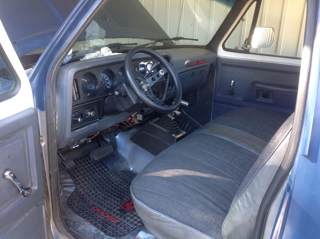

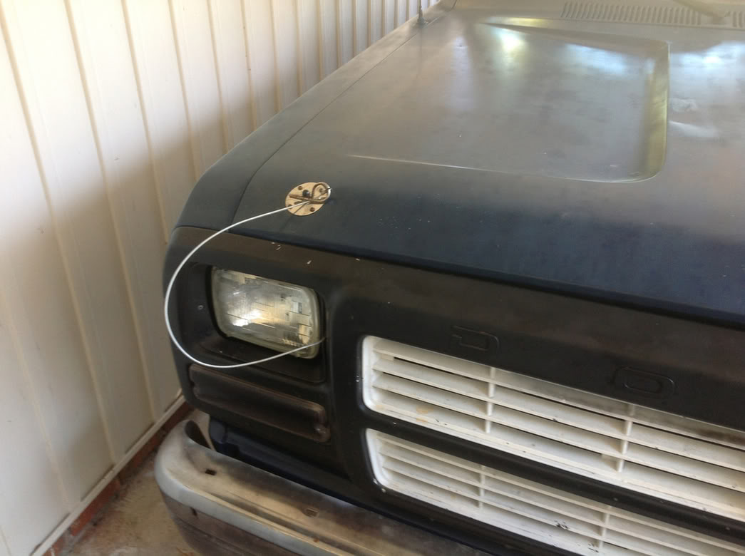

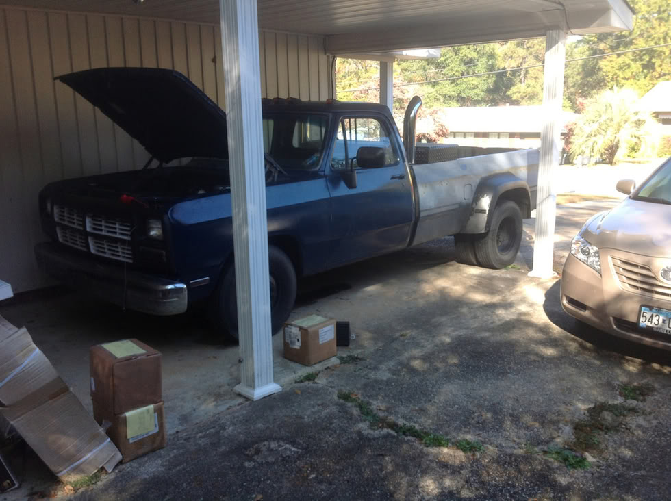

I hope these show up! Let me know if you guys can see them!

Not a bad looking truck but you can sure tell it was owned by a Young Kid IE butchered steering wheel and the fancy floor shifter

hood pins

It is a race truck. What do you expect
