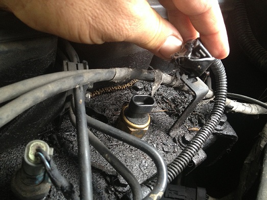

I haven't been on here in a while, but I just bought another truck and have a few issues I thought you guys might be able to help me with. I bought a 93 dually with manual transmission. The truck had sat up for about two years, so I dropped the fuel tank, cleaned it all out, replaced the fuel filter and cranked it up. When I test drove it, it was running rough, so I figured the fuel was bad (I had already drained the fuel filter and it was full of water and gunk). So when I cranked it up, it was slightly better, but still not running right. When you mash the pedal, it falls on it's face, then starts missing and bucking real bad. When you drive it, once you get it past a certain rpm, it smooths out somewhat but you can tell it's down on power and missing. I cracked all the injector lines, seems like pretty good fuel flow. So my questions are: 1) Do I need to pull the injectors? and 2) What is that plug on top of the manifold? It is the one closest to the firewall. I tried uploading a pic but it was too big. It has been disconnected and the harness has a jumper wire to bypass it. Does it have anything to do with timing and could that be causing the rough running? It idles fairly good, but not perfect. Thanks in advance.

http://s1216.photobucket.com/upload Here's a pic of that switch...hope it works

Here it is, I hope

If I am looking at the pic right.
That is the manifold temp sensor.
It should have a wire that runs to the KSB to advance timing for cold starts on the '91.5-'93 12Vs.

The temp sensor / KSB not working, shouldn't make the engine run like you describe.
It just is there to tell the KSB when to advance the timing a little.
