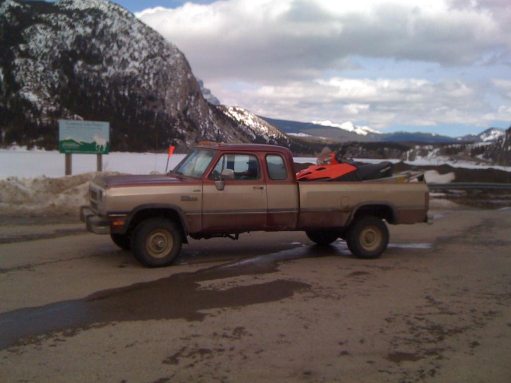

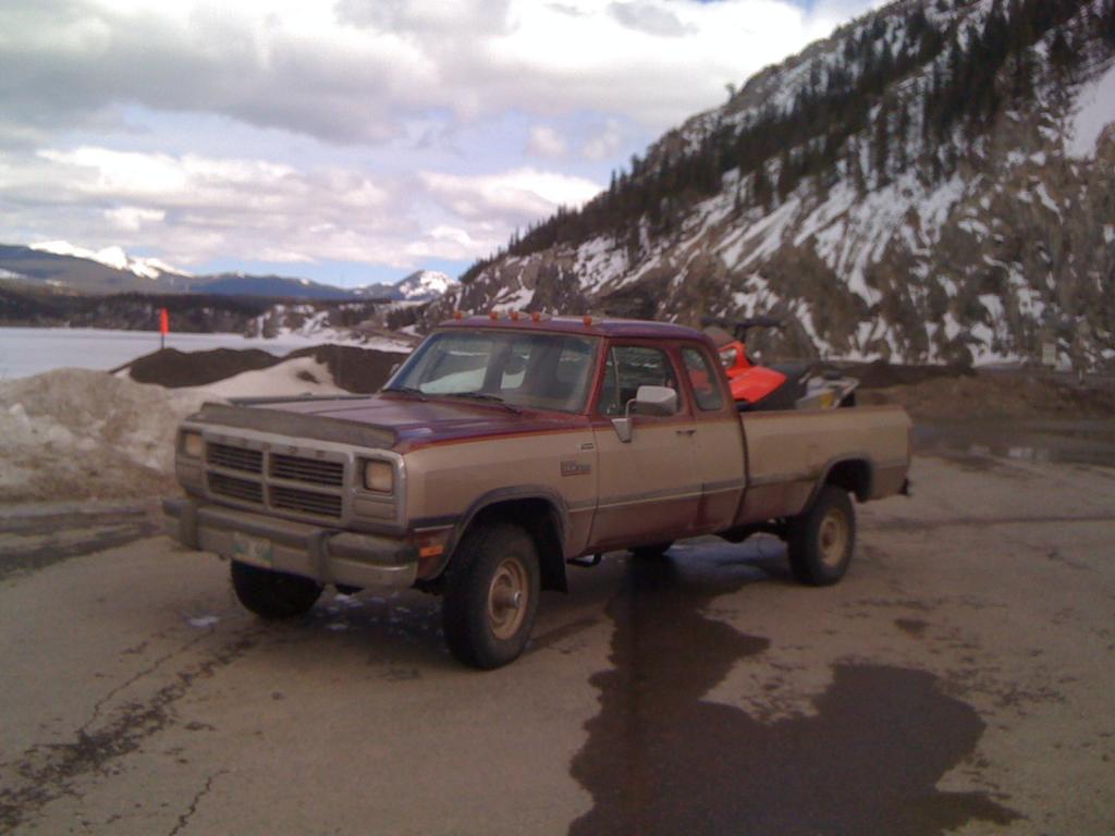

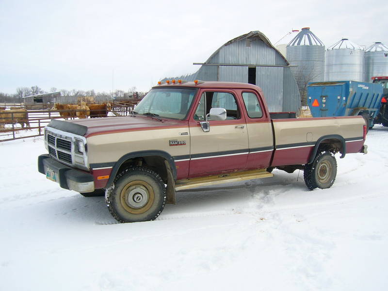

Yeah, I expected to do most of the items I did repair. I wasn't expecting to have so much oil leaking from the engine however, and I didn't know it had no tailgate. But as a bonus it has a gooseneck hitch and a trailer brake.
Here are some pictures from my travels and a cleaner picture from when I bought it.
Attached Thumbnails New Owner & A Road Trip Story-img_0457.jpg   New Owner & A Road Trip Story-img_0458.jpg   New Owner & A Road Trip Story-mintcummins-.jpeg
