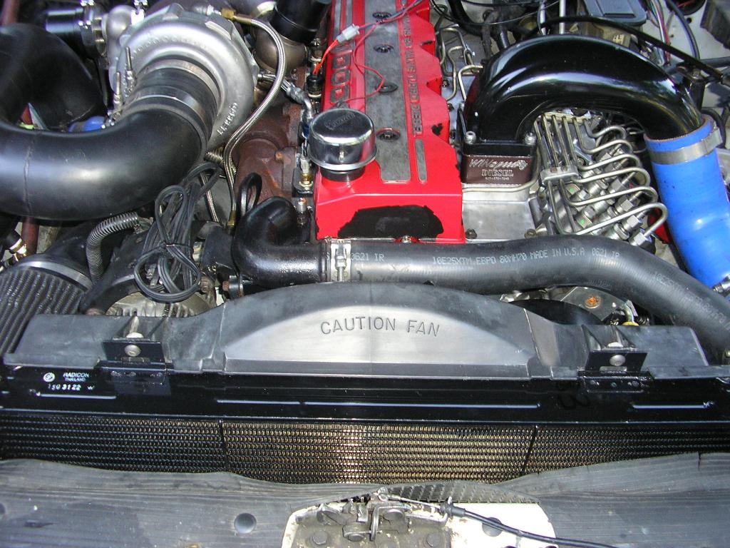

Drove it home yesterday evening. Seems to run well and dropped a few degrees on the pyrometer. When you guys finally wear out the last 5.9 it will hopefully be comforting to know that the 6.7 fits in nicely.

Can you give more details about the swap? wiring changes, emissions stuff, etc?

No emissions, same wiring as a p-pumped engine. First gen front hardware fits. motor mounts fit. Different eng adapt plate, and needs mods to pan/timing cover, swap straight cut gears.

Is it alot quieter than the stock 5.9 (underhood)? The new trucks are so quiet, not sure if its mostly due to motor or other things.

I think with the mechanical injection its gonna be louder.
