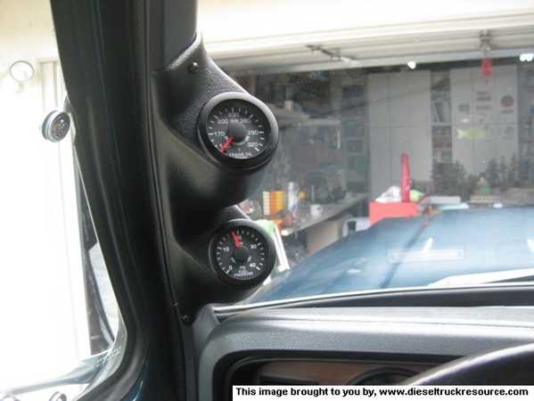

Here is my new EV2 FP gauge in its new home. Also the new lift pump and sender in the Banjo from Geno's.
I also replaced my IC boots. Thought I would squelch any issues with 17 year old boots but mainly I just preferred the clamps that came with them. Much easier to deal with.

These EV2 gauges are sweet huh? they look really good at night too. I wish I had that much pressure though!

It's not too expensive and an easy MOD. They are sweet "Blacky". Now I'm looking at my old "Banks" gauges and thinking hmmmm. I just picked up an HE351cw that was rebuilt. I'm gonna PM you soon with a question or two.
