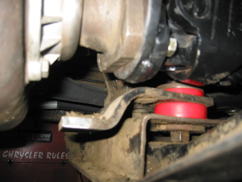

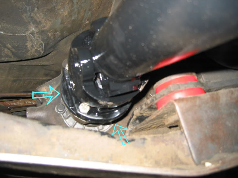

The stock front drive shaft was thrashed. CV was pretty slopped out, as well as the splines. Plus, the pathetically small mopar u-joint. Here's the new one, 1350 cv with a 1410 at front axle. 1-1/2" -16 spline slip yoke. Poly trans mount too, while we were at it.

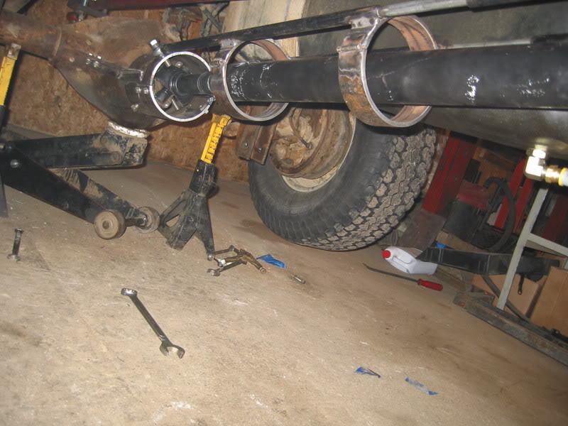

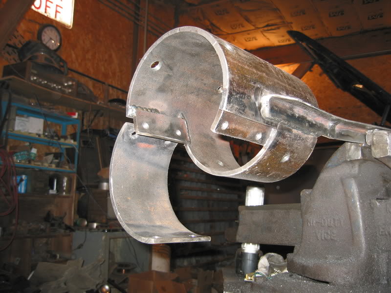

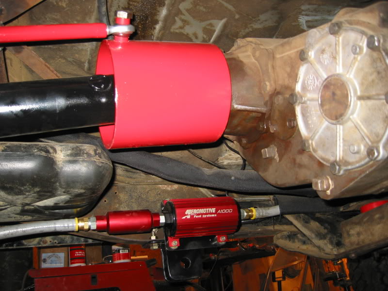

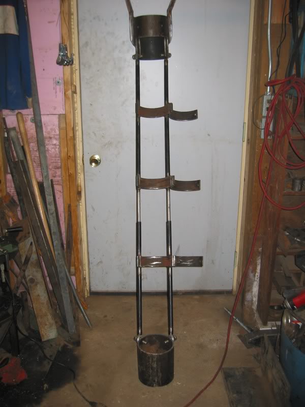

Almost done with the rear ds loops/ u-joint shields. 6" pipe, has about 6" of slide to it. Also heim joint ends for flex, since they were layin' around.

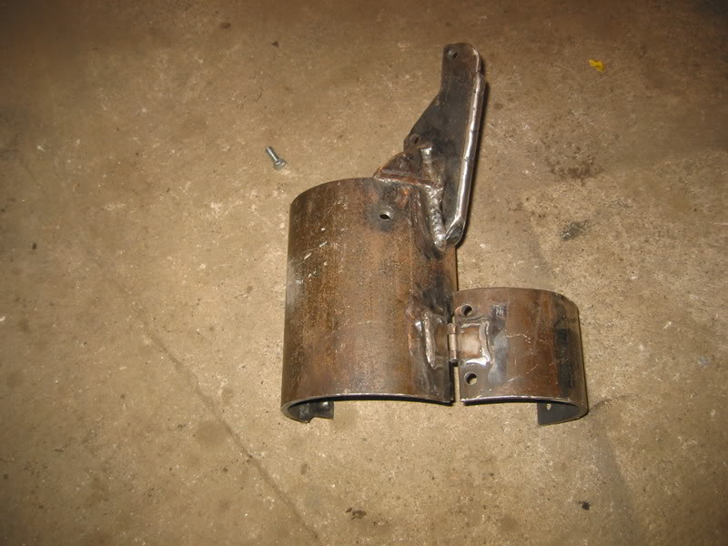

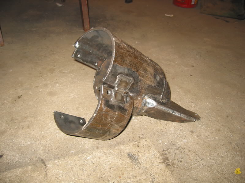

Hinges to make it easy to drop the 'shaft. I put one on the rear guard, too.

Old Feb 13, 2009 | 06:36 PM

Let us know what you think of the poly trans mounts...

I like it... Looks cool, like the hinge idea... Front shaft looks good too... Definatly a lot stronger with the 1410..

Here is the mounts: KMY part # PRT 4-1604
http://www.kmjent.com/cart/product.p...4&cat=0&page=3
They fit perfect and are 100x better than the mushy old ones. You used to pull on the driveshaft and the whole engine/trans would wiggle side to side about 3/4".
It is a superduty front 'shaft. I looked through a lot of u-joint catalogs. According to what I found, all superduty's had a 1350 front driveshaft. From a '99 f250 gasser auto to a '07 f-550 diesel stick. I was trying to find a 1410 cv, but settled for 1350.

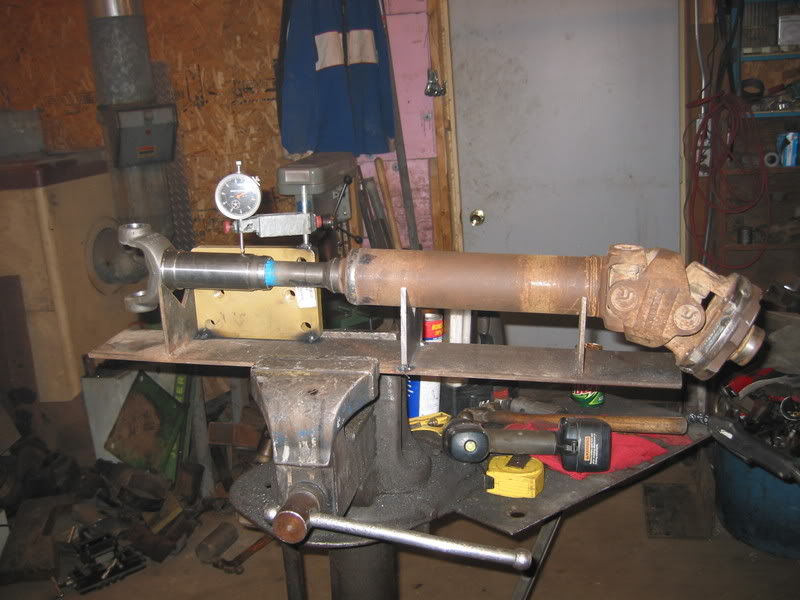

Like has been said it is a spare yoke from the rear axle. On the cv end, there is some custom work. To make this a "bolt on" you need to buy a new output flange that is setup for a 2" pilot. The stock one is 3.125". So after some brainstorming , this is what we did. Cut the very end off from a stock cv, and surface the side you cut on. Then you have a spacer basically. Then drill the holes in the new cv end out to 7/16(they are threaded 12mm). Bolt the cv with spacer to a spare flange. Once it is all tight welder 'er up. With all four bolts started there is basically no movement. It will be fine.

Then, you order a new slip yoke for a 1410 joint and you are done. You could buy a new 1350 yoke for the 60, and use the ford slip yoke. It was only $5 more for the slip yoke than the pinion yoke, so I got that. All in all I have about $150 in it with a new Spicer 5-801X(non-greasable) u-joint, Spicer slip yoke and Spicer strap kits. I got the 'shaft at a junk yard.
This is how I make them:
I use a flat bar to get the yokes phased right, and then that fixture to get the end straight. It was perfect, but is about 0.004" out after welding. You can heat and cool the tube to straighten it, but I said close enough.

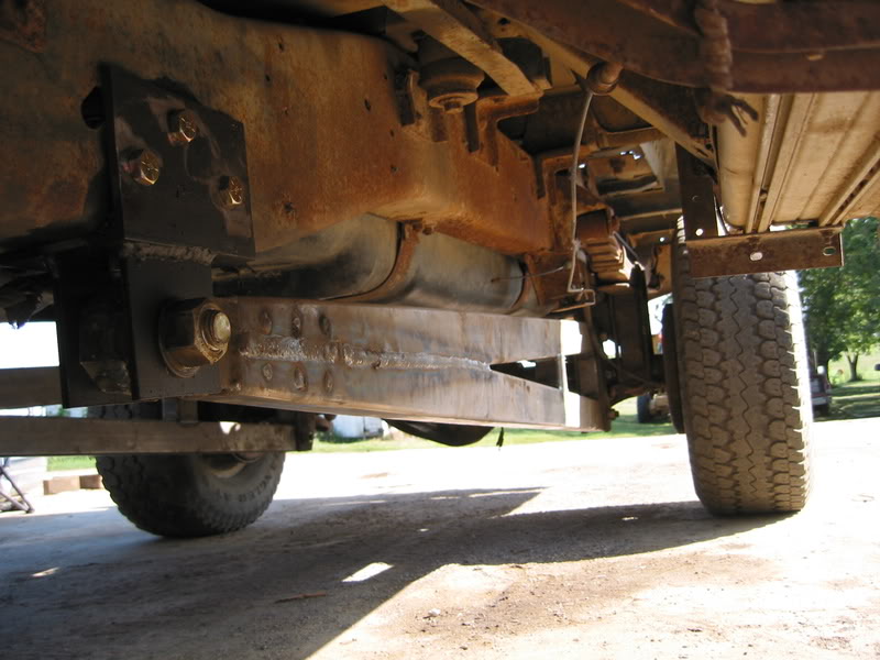

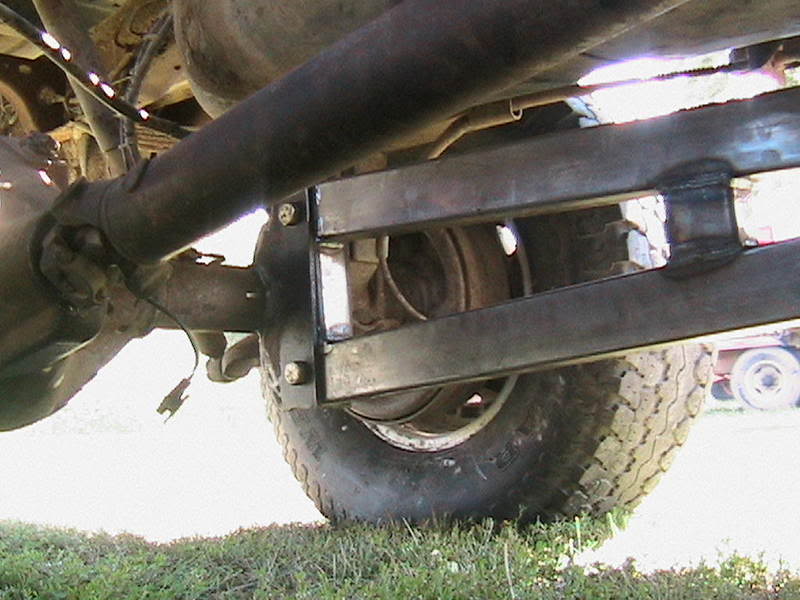

Ladder bars? They are done. Painting and rounding all the corners on them right now as well.

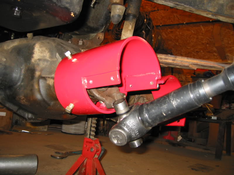

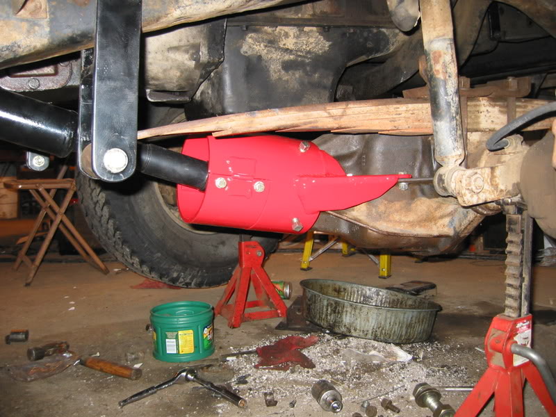

Got the front shield done:
Installed:
Dropping the 'shaft:

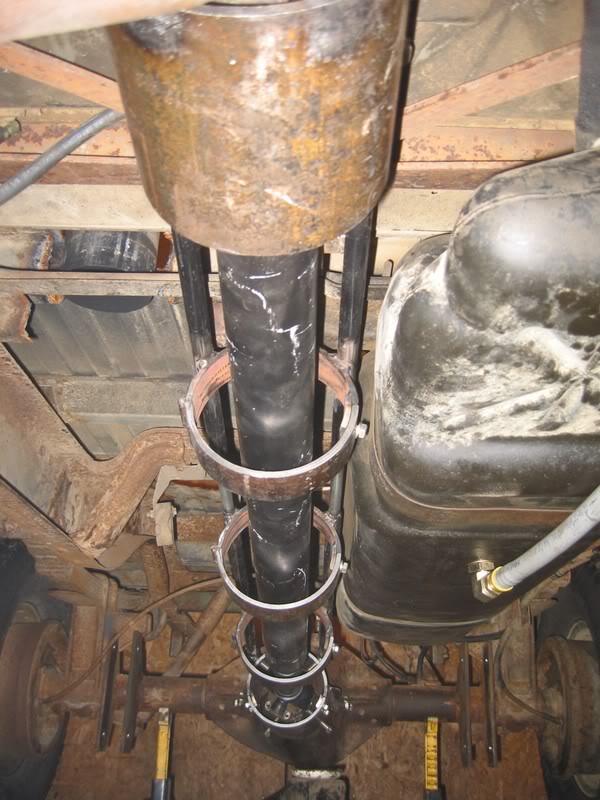

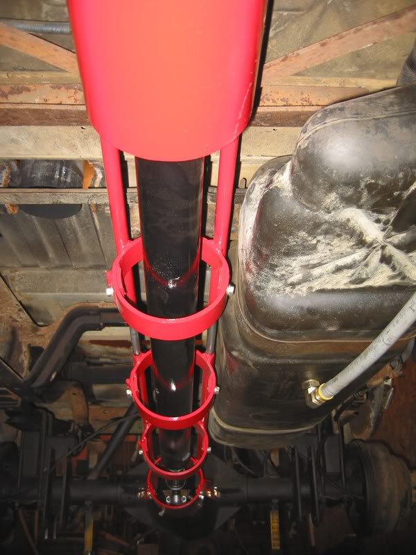

Got the rear ones painted too. Added the extra bolt in the middle rings:

WOW man looks good deff overkill but i love it evrything and the red makes it and nice to see somone else thinks about removal of things cant tell you the dumb stuff ive seen

looking good for sure, those ladder bars are stout to say the least!! If you get time tell me a little about your fuel supply system.. I really like the front yoke shield, it looks cool and looks to function well..
