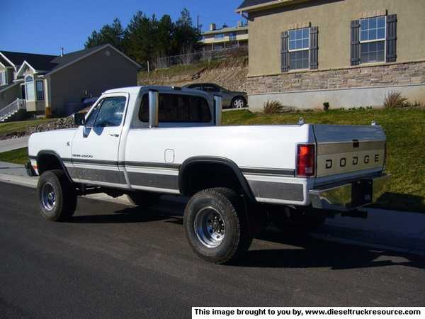

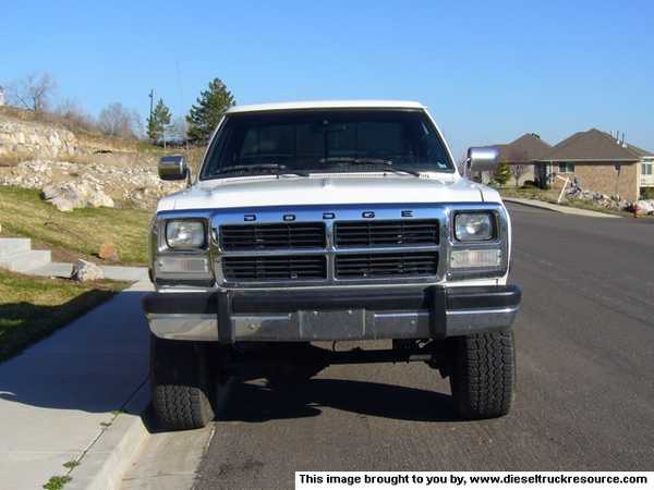

Well, after a few years of looking, I finally found what I was looking for.
Here is the rundown:
1992 Dodge W250 single cab 3/4 ton single rear axle
5.9L Cummins Turbo diesel intercooled
HX40/18cm2 Holset turbocharger
4" turbo-back exhaust split to dual 5" stacks- straightpipe
5-speed NV4500 transmission (upgrade from stock Getrag) 2005
new transfer case in 2003
Dana 70 spicer rear limited-slip differential
3.54 rear end
trailer brake controller
gooseneck plate
Class 5 trailer hitch
Auto Meter Cobalt series EGT and boost gauges
Mickey Thompson tires
6" Skyjacker lift
220k

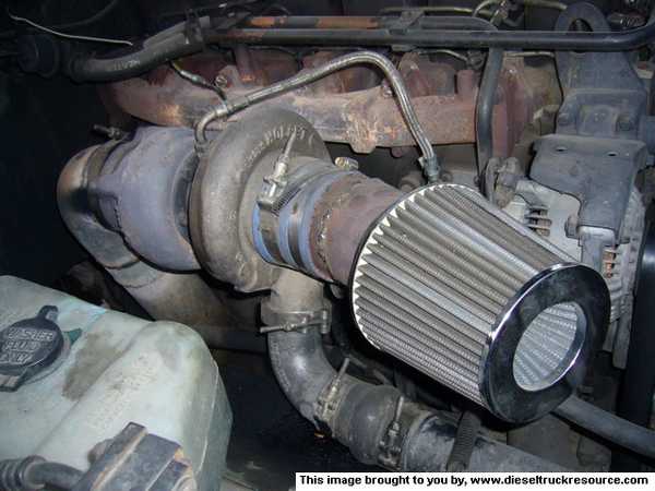

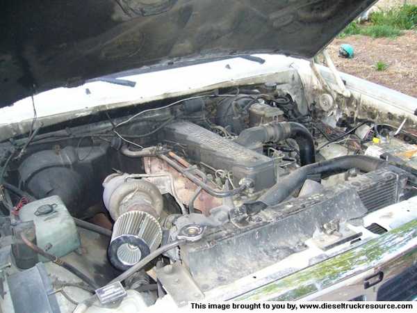

Here are some pictures of the engine bay:
Intake is not my doing. Filter is from Checker. Compresser blades are filthy.
[IMG][/IMG]

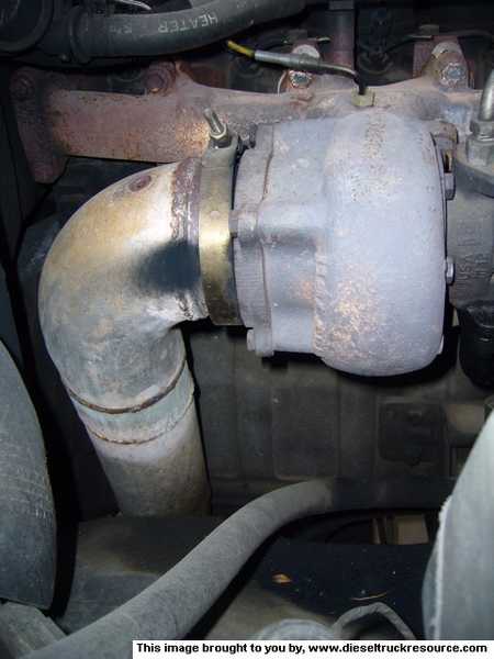

I'm still trying to find out exactly what this turbo is. I think it's an HX40/18cm2.
[IMG][/IMG]
4" exhaust outlet and downpipe
[IMG][/IMG]

Any answers to the questions #1 and #4 would be appreciated. I need to figure out what to do with this turbo. Too laggy. I like the 4" outlet, but too laggy. Sounds like a Peterbuilt.

From the engine bay pic it appears you have a '92.
Unless you plan on big injectors you ought to drop back to an HX-35 or H1C hybrid, the truck will run way better.
