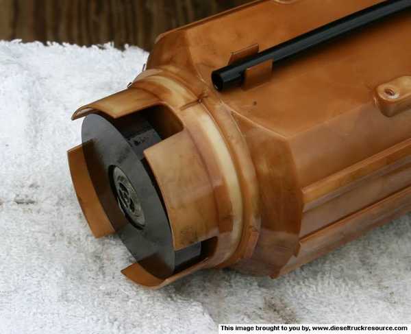

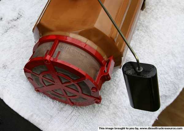

Hang on to that RED fuel pre-screen. It's unique to the diesel application (gas is green if I'm not mistaken).
It snaps on and off exposing the fuel pick-up valve float (don't break them ).
