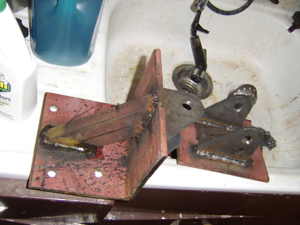

Nice looking '89 there avengerdude27. I made a custom "borgesen" using a u-joint assembly welded to the metal "housing" that goes over the splines for the steering box end and then just welded the other side to the bottom of the steering shaft. Now it has a rag joint on one side and a u-joint on the other. I can't remember where I junkyarded the part from though. Got any pics of the shackle flip on the rear? Did you use the stock shackles or go longer? I have a custom set of hangers already made to install on my crew cab so I can ditch the stock blocks in the rear.

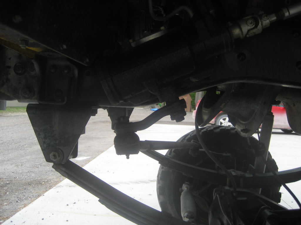

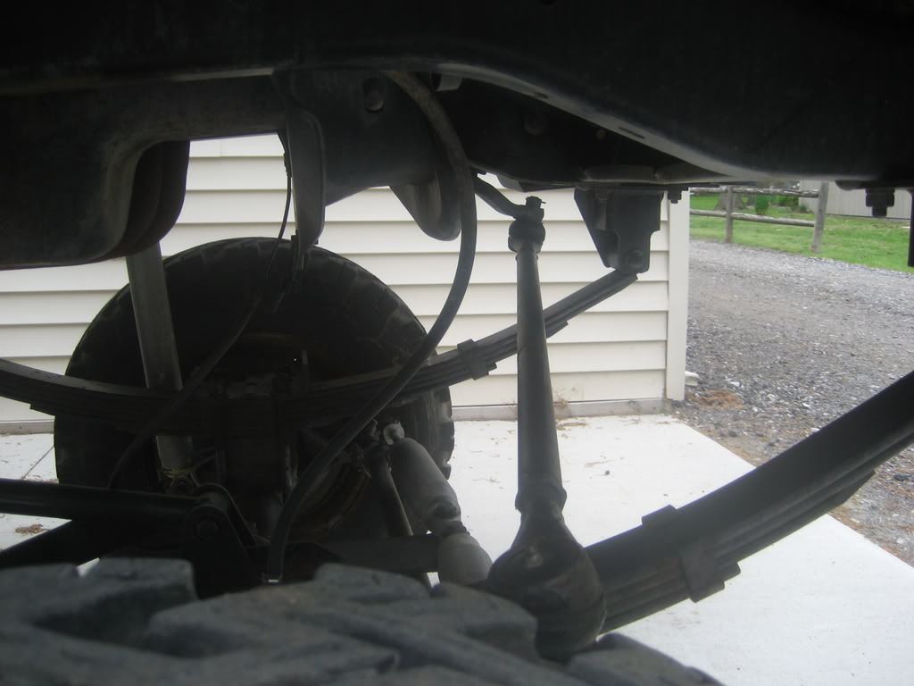

Its nice to see O.R.D making a cross over kit that actually looks like it works. Back in the day, maybe 5 yrs ago when I was looking to do cross over on my wheelin truck, they sold a kit that you had to notch the engine cross member. So I engineered my own that works awesome but requires a decent size lift. Here is a few pics.
On the lift kit, there are many options, I would stick with skyjacker, most of the time there springs are pretty good. I would do whatever I could to eliminate the rear blocks, possibly with a shackle flip, then maybe a 4 or 6" spring to get you the lift you want. up front definatly go cross over if going over 4", or else drop pitman arm and adjustible drag link, but for a few bucks more, I would go cross over. Also I would try to stay at 6" or under, the angle on the front drive shaft becomes pretty steep, have to grind out the cv to get it to clear, definatly need to get it lengthened no matter what. God luck, don't be afraid to hit me up on ??
ill get some better shots from under the truck this weekend
the rear hangers are shorter the fronts are lower and the shackles are longer

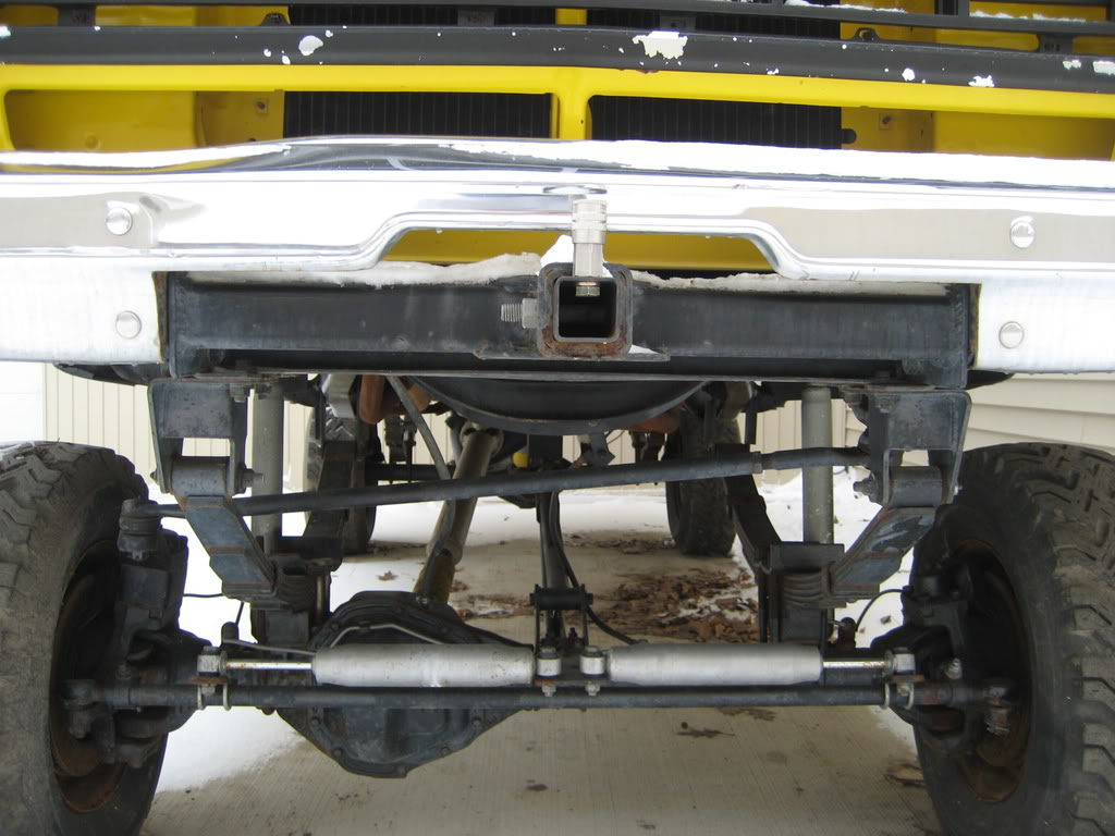

before o got the new front hangars on and paint

jeez look at the angle on that front driveshaft!
Looks like It's just hanging from the transfer case.
Old Sep 19, 2009 | 08:14 AM
avengerdude27's Avatar
Joined: Oct 2008
Posts: 61
it was, i was waiting on a new u joint
Old Sep 19, 2009 | 09:32 AM
Rick 12v CTD's Avatar
Joined: Oct 2008
Posts: 1,591
Likes: 11
From: Thunder Bay
yeah I was kind of wondering about that. Thought maybe my eyes were playing tricks on me just there.
