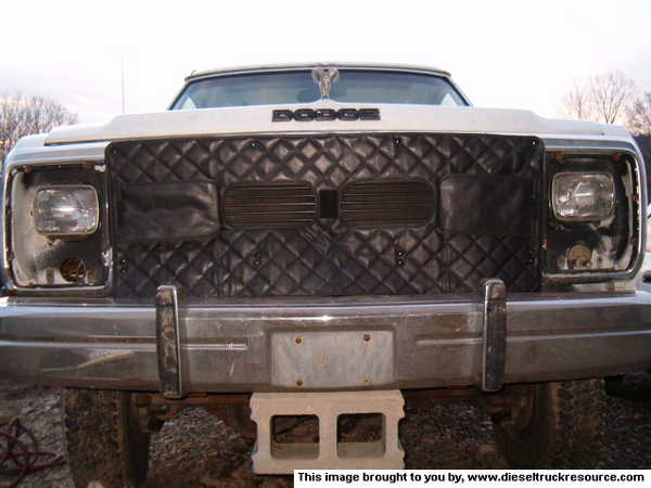

I feel your pain, Fury. My factory grille sits on the garage floor and I'm using my winter front as a center section for the time being. I have the extra problem of the intercooler sloping out toward the bottom because it's taller than the core support...haven't found a solution, but haven't really been looking since my truck is no prize winner anyway....
