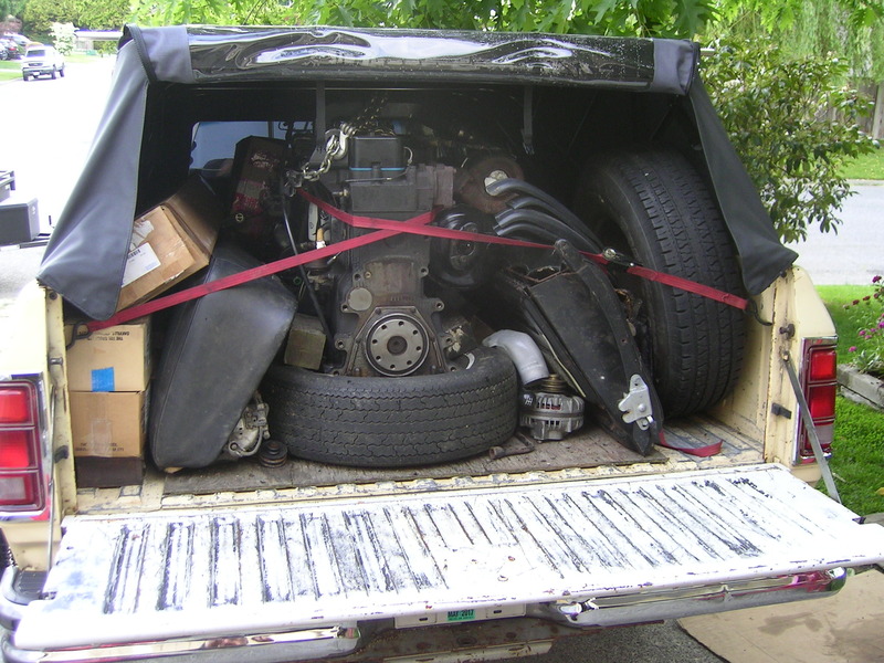

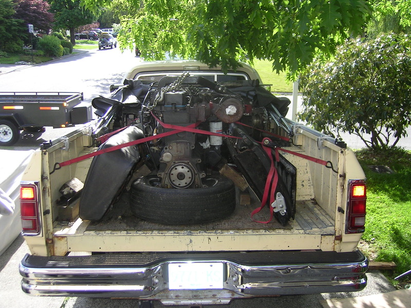

So borrowed a small utility trailer from a friend and loaded up most of the big heavy stuff. Complete 89 Cummins motor, 4wd A518 and Np205, a dismantled 440 and tons of other parts, and tools etc.

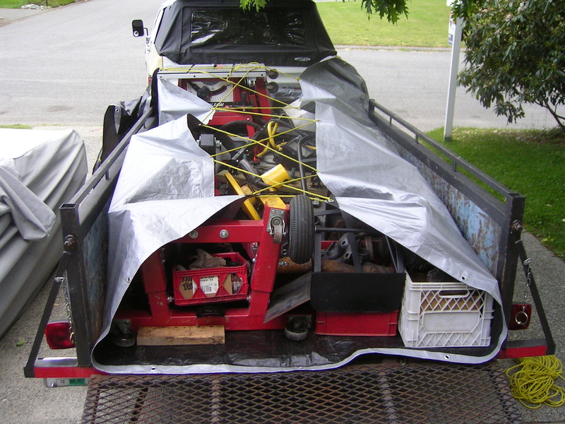

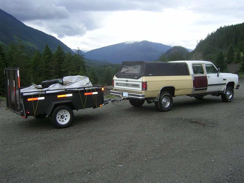

Trailer all loaded up....

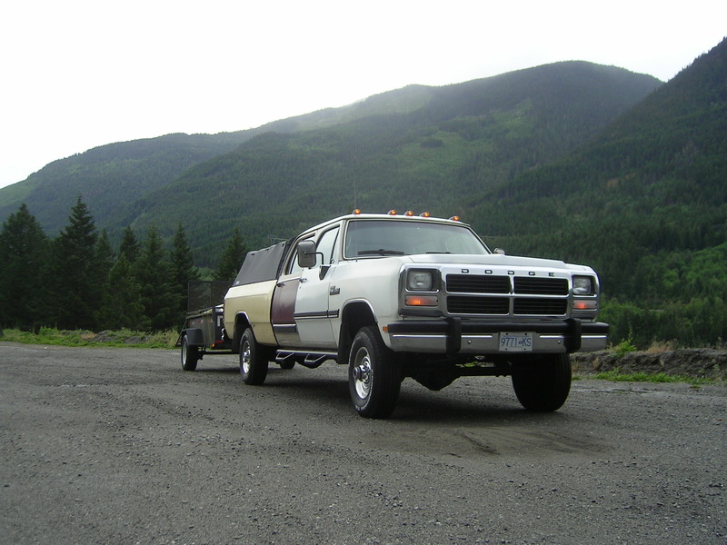

And a couple pics up in the mountains...love this spot!

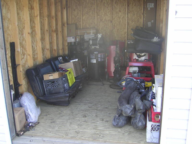

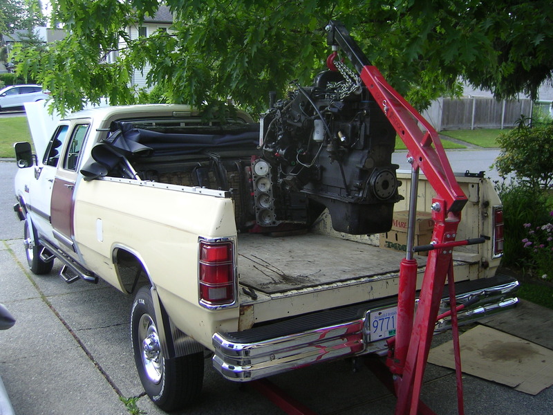

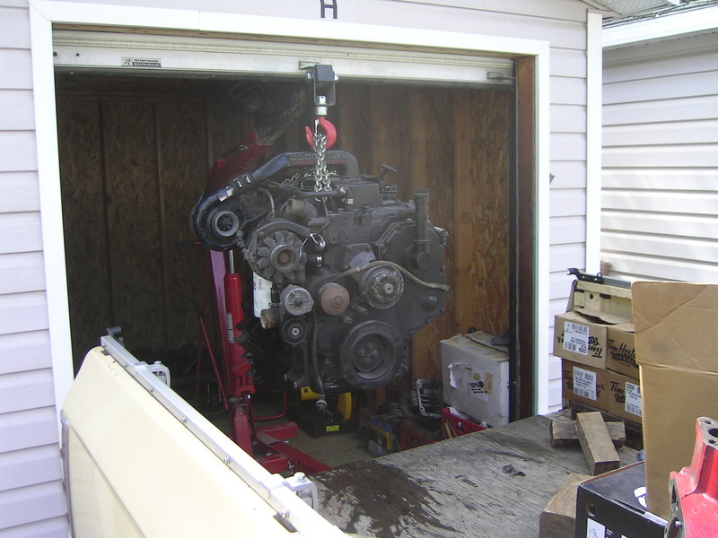

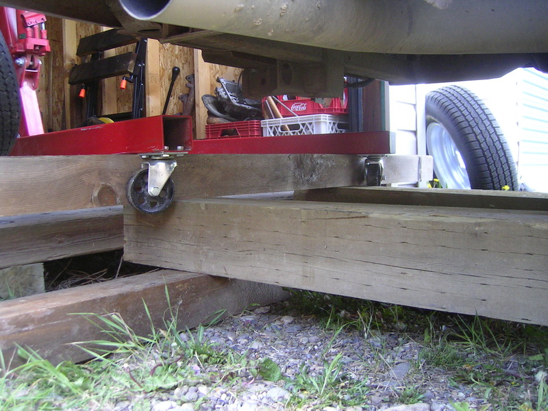

I had reserved a storage unit...8x12...and was under the impression that it was on ashphalt or concrete...well it was not, and it was raised up about 10" off the ground.
I was on a tight time line as well, so now had to get a friggin 1000lb cummins motor out of my truck and into the storage unit. Thankfully there was a pile of used posts near by, so I was able to build up a quick block set-up to help hold the hoist.

Was a lot of muscle required to finally drag the motor into the unit. But got it done with minutes to spare.

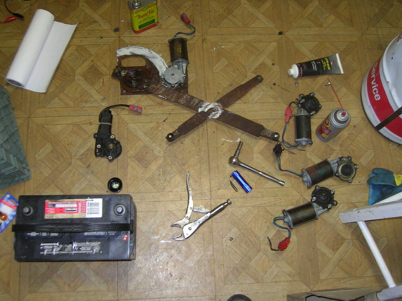

I was finishing up the loading process here at the house, and was locking up the truck...rolled up the windows and the drivers window went crunch and ping and then dropped halfway down into the door...NOOOOO!
I figured the motor had stripped. So i wrestled the regulator out of the door...what a PITA! and swapped in a spare motor.

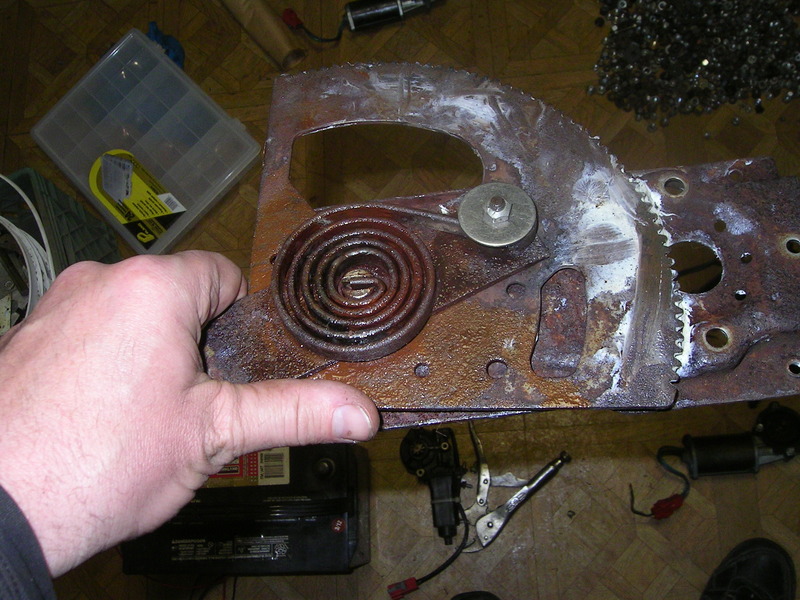

Re-installed everything...and yes the older large motors will fit fine. and the motor would turn, but the window would not move. So out everything came again.
This time I had to figure out why the regulator was not working. Turned out the pin that holds the big spring in place, also secure the arm tight to the cresent moon set of gears. My pin had snapped. Well the simple fix would have been to just weld the arm in place, but my neighbour had borrowed my welder, and it was now about 10:30pm....so couldn't be waking them up for that.
So I managed to get the old pin out of the way, find a bolt with a head thin enough to clear the regulator body, and then use a couple stover nuts and washers to hold the spring in place.

Well it worked...at least for now. Got to bed about 1am, and had planned on leaving at 4am, but needed at least 4 hours. So left at 5:30am.

question, is that trailer homemade? if so i made one that looks almost the same

No a friend bought it used and abused, and refurbished it. I built the fold down tailgate for it.
