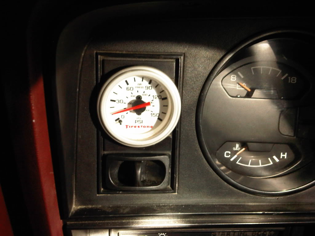

Airbags are complete!

Does the compressed air blow through that vent?

  #192
BILTIT's Avatar
Joined: Nov 2010
Posts: 2,205
From: Lloydminster SK/AB
Haha, good idea. Would atleast be some form of AC!
