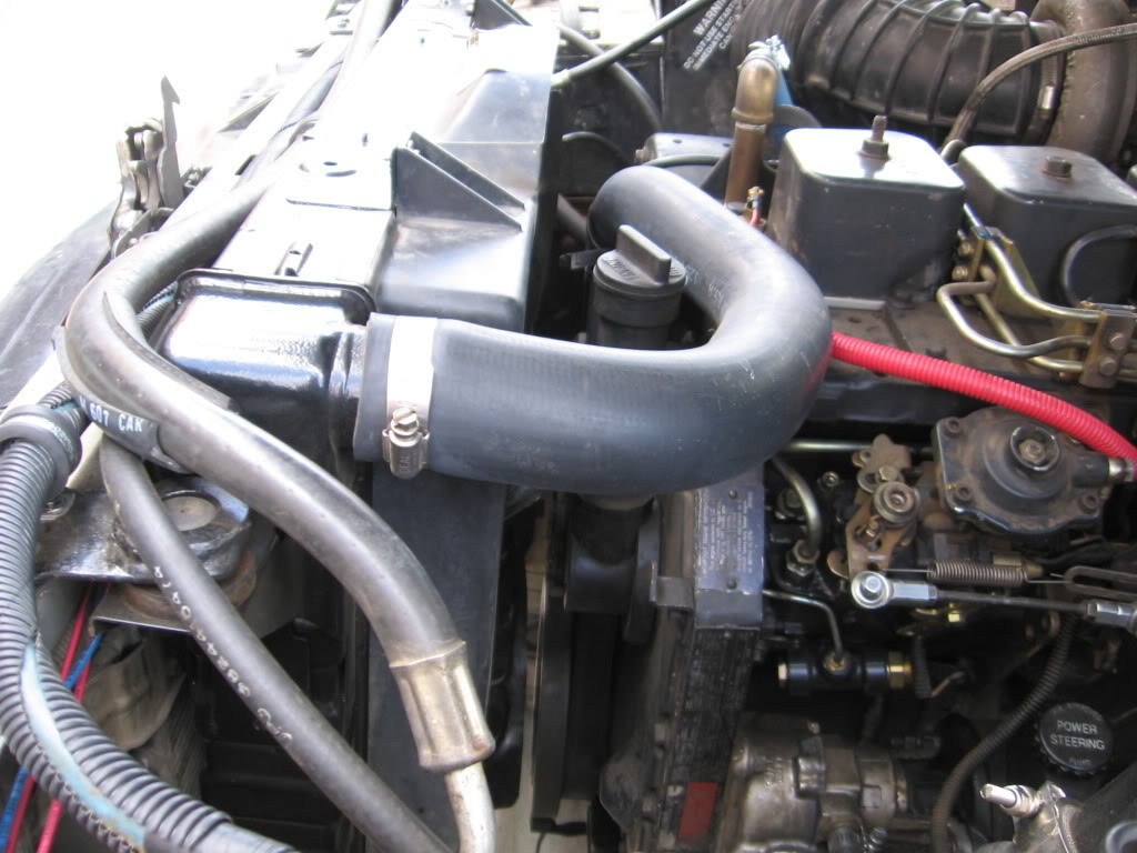

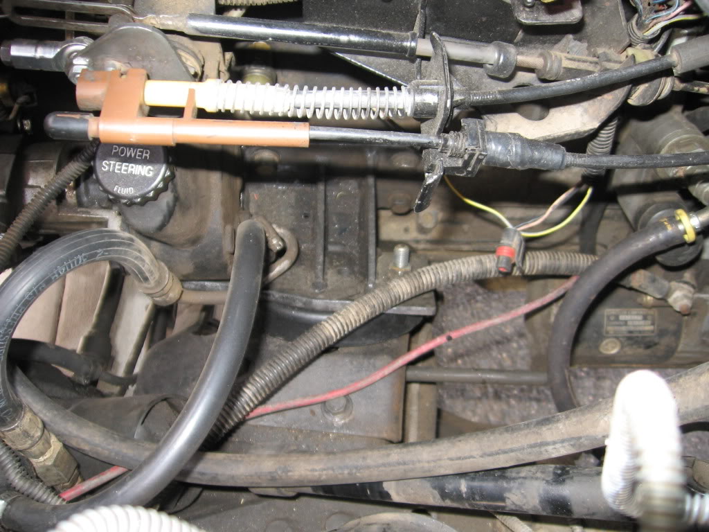

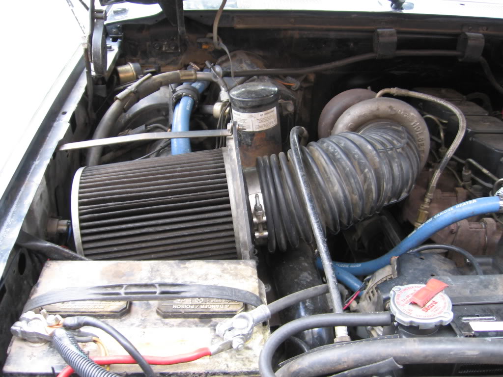

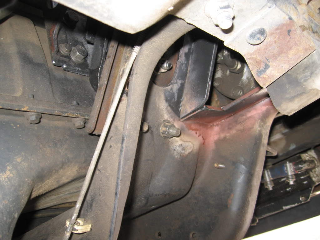

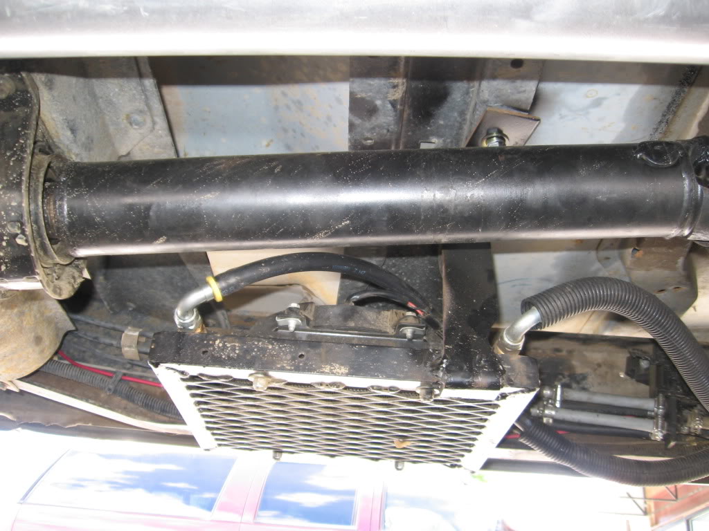

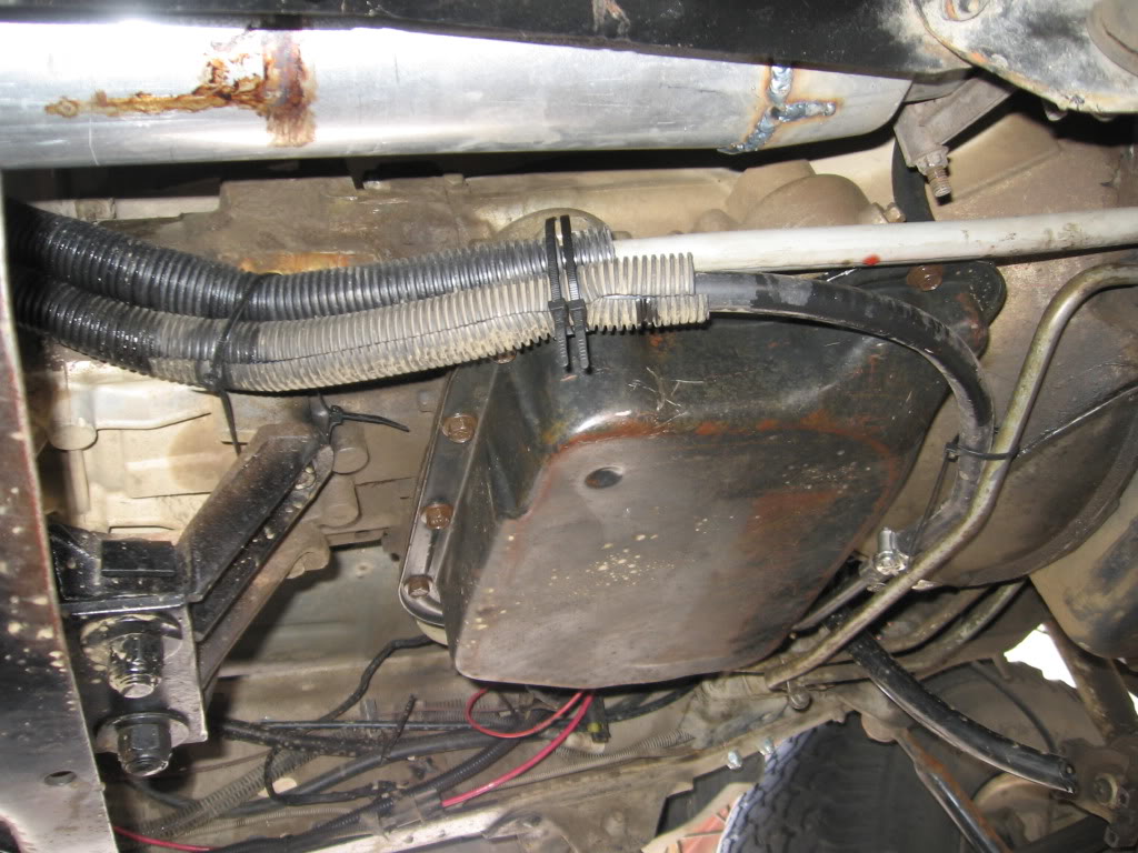

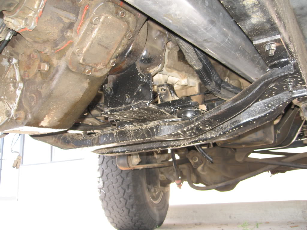

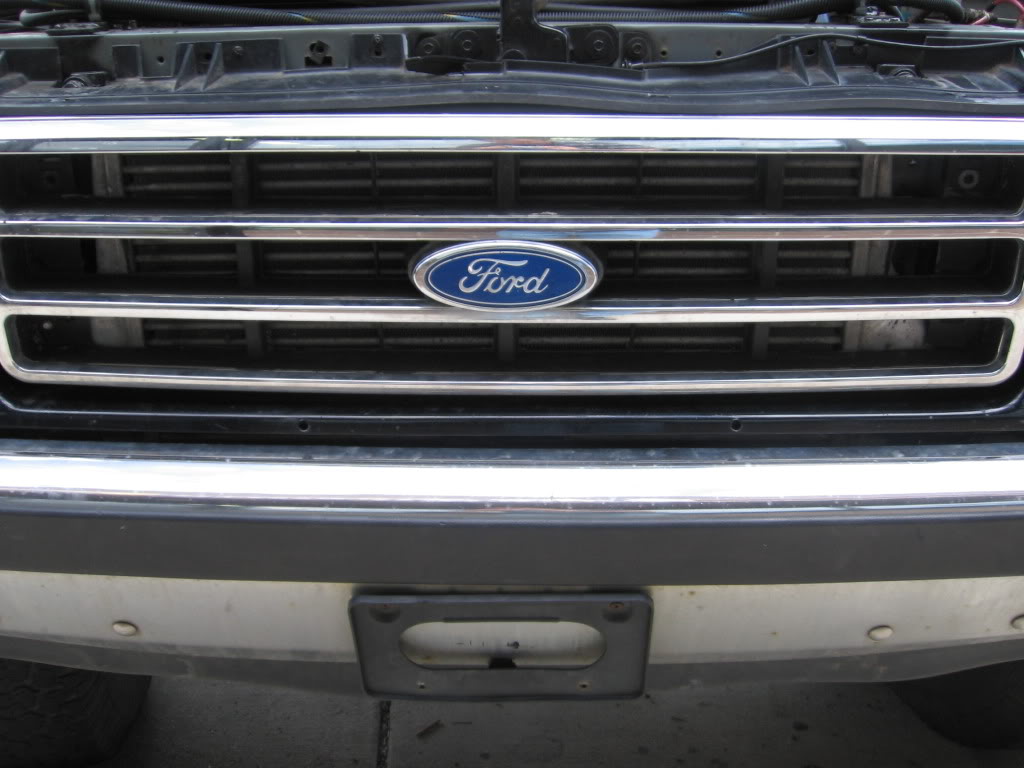

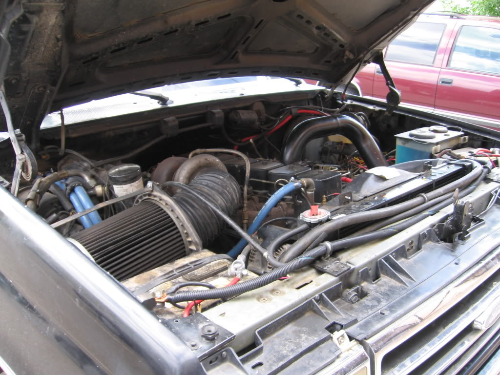

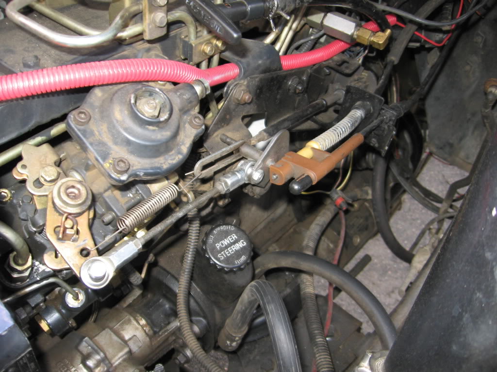

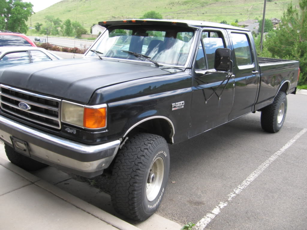

Pictures!
its on the road, not completely finished, but enough I can drive it!
for your viewing pleasure. haha

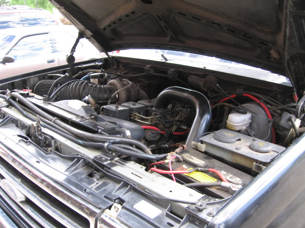

and some more...

Originally Posted by apwatson50
That is gonna be one nice truck when you get it done.
One bit of advice from someone who spends long hours looking down the sides of big trailers :
See how the mirrors are mounted way back in the center of the doors ??
Remove those mirrors/brackets and re-mount them as far forward as the door will allow.
You can use those nut-rivet gizmos, or just remove the panels and bolt straight through with fender-washers/nuts on the inside.
The first time you sit naturally in the seat and merely shift your eyeballs to see perfectly in the mirror, without the need to lean way back in the seat and reposition your head, it will be worth the few minutes of time and extra holes in the doors.
You can plug the old holes with stainless machine-screws and, everytime someone asks you about the extra screws, you get to show them how smart you were to relocate the mirrors.
Mine have been relocated since about 1985 and now I can't hardly drive a truck that has the mirrors in the stock location.

Went camping this weekend, pulling a 7x16 enclosed trailer with a bike and a quad and camping gear. Probably weighing ~4000#'s? And well the trans sucks. Up in the "hills" foot on the floor in 3rd would maintain speed but the trans oil temp coming out would be 250deg.
Power wise and engine temp was fine, the highest the engine got was 210deg and I probably could have hit O/D but who knows where the trans temp would have gone!
I have my aux cooler plumbed in but don't have the fan powered yet, will get that done this week.
Some day will have to get a Goerend Bro's torque converter, just hope the trans lasts until next year....
