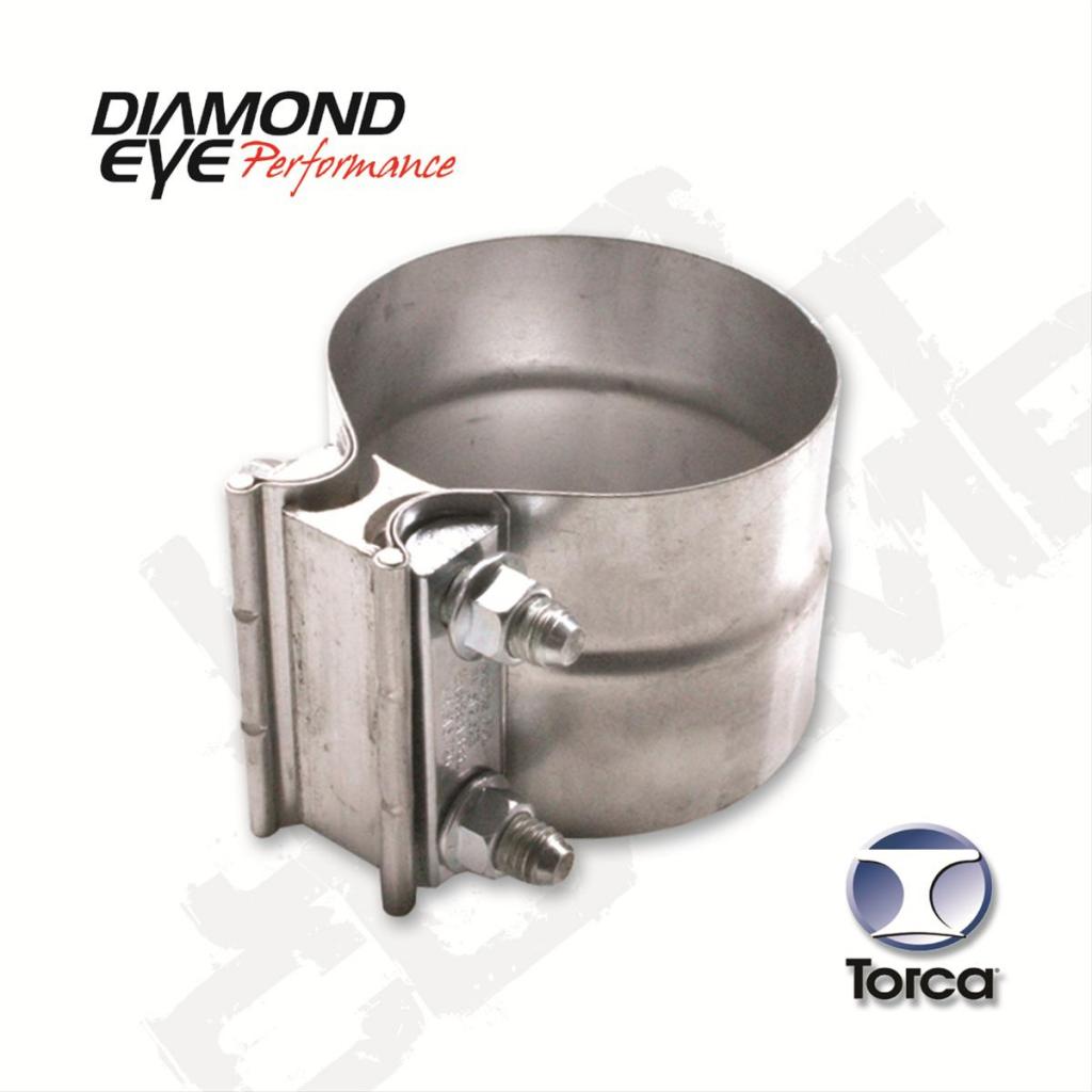

As for the band clamps, how do they work on joints where one pipe is expanded so the other slips into it? Slightly different diameters. Or are you guys talking about pipe to pipe butt connections? The DE is slip joints correct?

Yes the DE is slip joint, and the band clamps I use are about 4 inches wide. The ones I get at napa are just flat and will conform to the edge if the slip joint when you tighten them. If I buy them from a truck dealer they are actually stepped for the slip joint if that makes sense. Make sure you tell them they are for a 4 inch exhaust because they do come in many sizes.

the band clamps for the slip connections have a step in them to compensate for the lap in the tubing. the diamond eye are about twice the price of the walker $18 compared to around $8
The reason I posted the DE is the picture is better.

That was the best picture of the two the walker clamps are eight bucks but the picture didn't show the step I was trying to show
