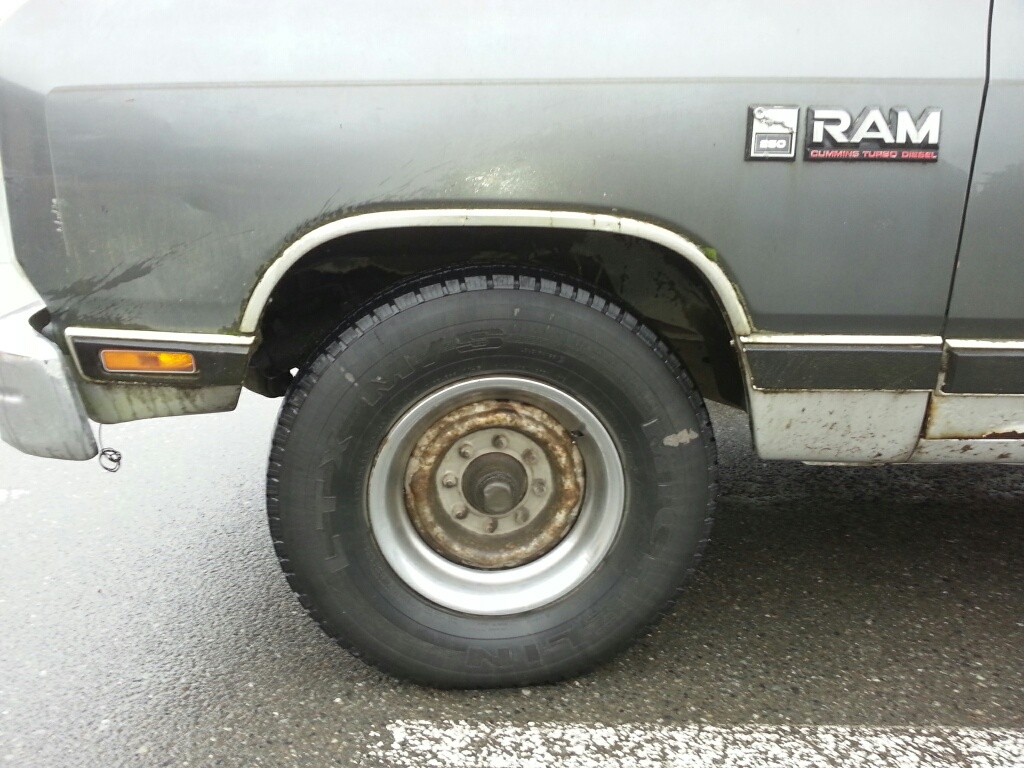

Old Mar 26, 2015 | 01:57 PM
u2slow's Avatar
Posts: 1,860
Likes: 425
From: BC
Originally Posted by PapeCAT
You can just leverage them into place with a floor jack under the lower control arm. (with BJ disconnected from the steering knuckle of course.)
What he said
EDIT: snapped a pic of my truck yesterday with the 7226s coils. They are 4 years old now, 2nd truck they've been in, maybe 10,000km total. Those are 235/85R16 Michelins (approx 30% left) on stock steel wheels. Rides like a Cadillac, IMO.
