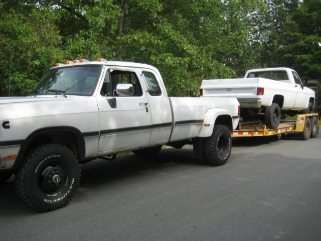

Originally Posted by Flake
A 255/85r16 should fit the wheel, but may not clear the front fenders without a lift or trimming.
no lift or trimming required. not many options though in that size.

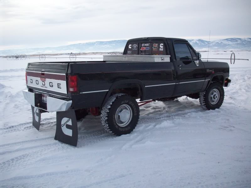

I got 285/75R16 on my truck and love them. They look a lot better too with the stock rims. Stock height and no rubbing.
