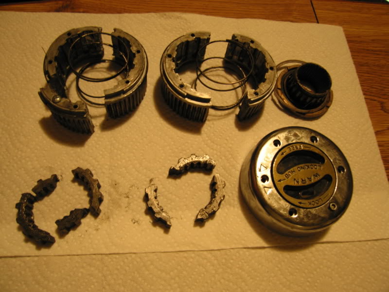

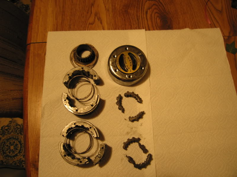

Hooked today, it was a hard, rough track. Blew both lockouts right off the bat. They were the "good" Warn one's too. Definitely don't have the setup for 2WD. They must have been less than 100%. They are supposed to have a lifetime warranty though.

Time for drive flanges

Ouch... Wow what kind of RPMs is he running? that thing sounds up there. And what turbo is he running?

tried to make a go of it at 4500 rpm....front end didnt hold together very long. and like curt said, she ain't much for pulling in 2 wheeler mode....

Wow that's some pretty impressive shrapnel

woooooo carnage. time for no hubs, just 1/4" plate the same diameter as the hub that is machined with splines and use some grade 8's. no lock out hubs, just solid 4wd all the time lol

Thats what drive flanges are

we made some drive flanges last year, they were stronger than the 30 spline outers....
when we upgraded to the 35 spline outers we went with lockouts because its kind of a bear to drive w/flanges and a welded diff....but as it turns out we will probably be headed back that direction...
