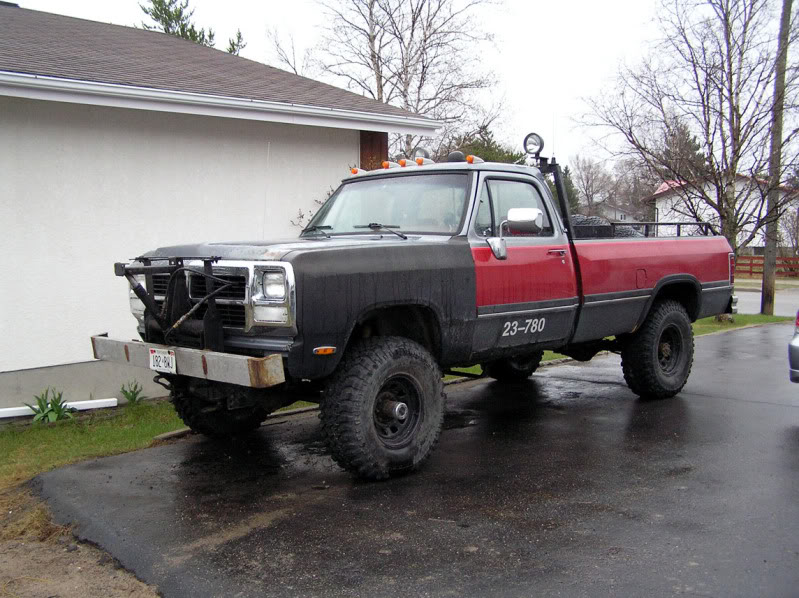

I managed to score a set of 8" skyjacker springs from a buddy for cheap. I re-used my stock mains, the 1st and second leaf below the mains out of the skyjacker pack, and the rest of my stock pack, minus the short bottom overload spring.
Went from this:
to this:
35's fit nicely, it rides better than any other first gen I've been in, and it cost me $150.

Where I got lucky is that I was able to add quite a bit of arch to the spring pack without adding spring rate, if I had of used more of the 8" pack, or my existing stock stuff was less worn out, the ride quality wouldn't be there.

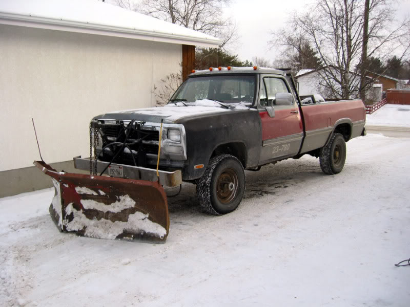

We'll see how it holds up to the plow this winter, that extra thousand pounds hopefully won't kill the springs again...
