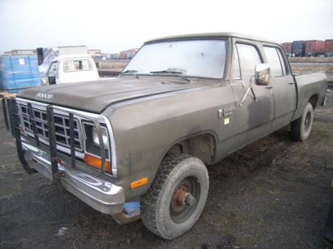

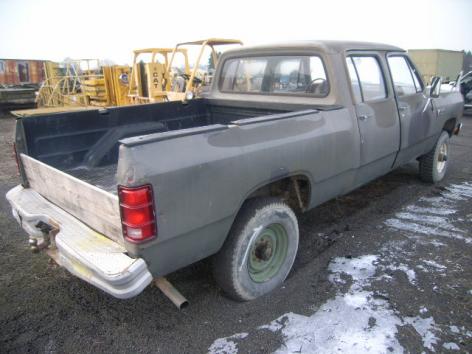

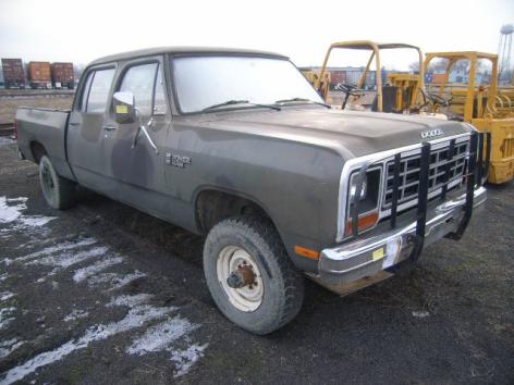

Hey guys just bought this 1985 W350 crew cab to put my '91 D250 Cummins/A518 drivetrain in. It is in good shape. A couple of dings and dents but no rust. I will be starting the heart transplant pretty soon.
Well let me know what ya'll think.
AndyT

$1700 and a trip from Ga to PA to pick it up.
My plan is to use the '91 dash, gauge cluster, steering column, wiring harness and seat. I picked up a used grille and core support off of a '92 a friend parted out. I am going to use the '91 Dana 70 rear. I figure I will have it going by the end of summer.
