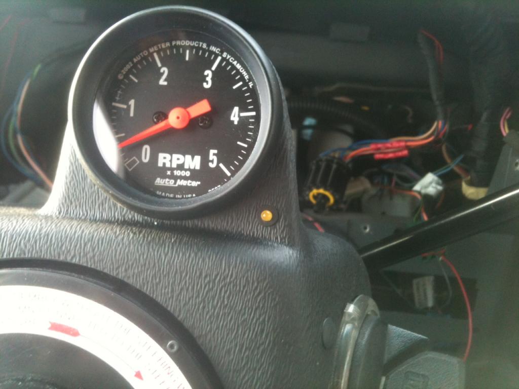

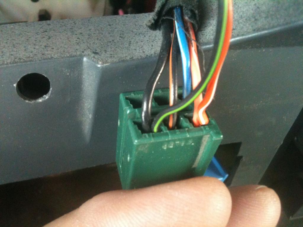

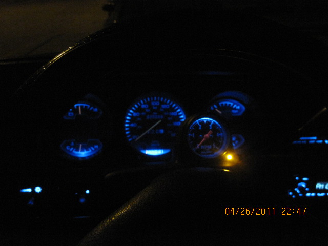

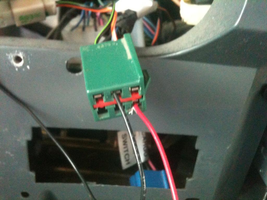

I lucked out and found one in a boneyard. It was a gasser so be stuck just checking diesel trucks. I picked it up for $15 Works like a charm! I removed the original switch but kept the plug intact on the harness. I then installed a 3mm amber LED in the tach pod & wired it to the plug.
Let's Screw-Up Your Steering Column With A New Tachometer and Gear Shifter!-od-shifter-connection.jpg
Stalk switch connections
Let's Screw-Up Your Steering Column With A New Tachometer and Gear Shifter!-od-light-connection.jpg
Pod OD light connections

Let's Screw-Up Your Steering Column With A New Tachometer and Gear Shifter!-img_1141.jpg
OD On @ Night
BTW, I checked at a dealer here for the shifter stalk and they wanted over $100 for one!

I did the 2nd gen shifter mod on a 92 and a 93 . I did as suggested and hooked the switch up in parallel . and in both cases the od light works off the column switch , just for any one who wants to know.

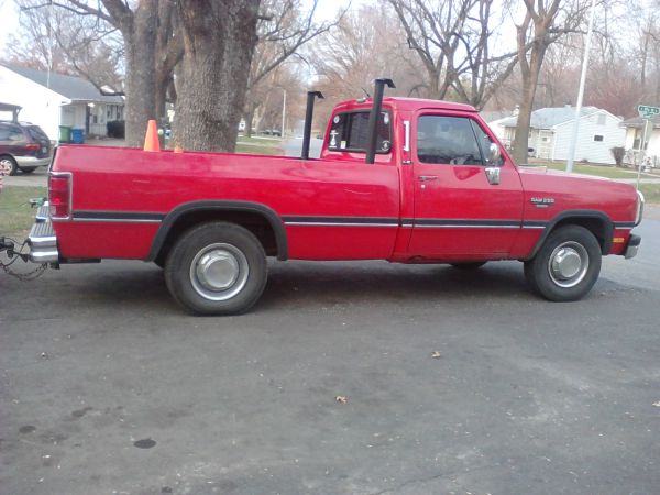

Posts: 1
THIS WAS VERY HELP FULL I HAVE A 93 D 250 THAT I HAVE BEEN PLAYING WITH FOUR A TWO YEARS AND IM ALL MOST DONE JUST FEW MORE THING COSTOM FLAT BED AND NEW PAINT AND ILL BE DONE
Attached Thumbnails Let's Screw-Up Your Steering Column With A New Tachometer and Gear Shifter!-93-dodge.jpg
Old Jan 28, 2013 | 12:12 AM
  #38
Jim Lane's Avatar
Posts: 4,084
Likes: 235
From: Southern California
Just wondering about how much visibility did you loose of your speedometer?
Looks like you might loose sight of the trip odometer, PRND12 and the high side of your speedometer.
Might be ok for most people but for someone with OCD it could drive them crazy
Jim
