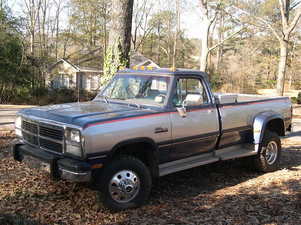

Howdy:
Leper: Alcoa wheels for duallies - I have mounted Alcoa #160242 and 160241 (one serial number is for front, the other for rear) - they were spec for Ford dually. There are two little studs on the rim that need to be punched out. Otherwise, your stock lug studs are the right dia. and give enough thread to fasten the rim. Your stock lug nuts will dig into the rim, so Alcoa has a 2-piece flange-nut for that reason, plus a cover for looks.
Firstgenfanatic: As for the the hub caps, Alcoa has a few different styles, primarily depth differences for the rear, and if you have a 4wd, a cover that's a little deep to my taste...
Here's an example on the pic., (click on thumbnail and max. window)

Oh drool drool drool! Beautiful dually!

That is a really nice dually!!! Not too many around here in that shape! Thanks for sharing that pic.
