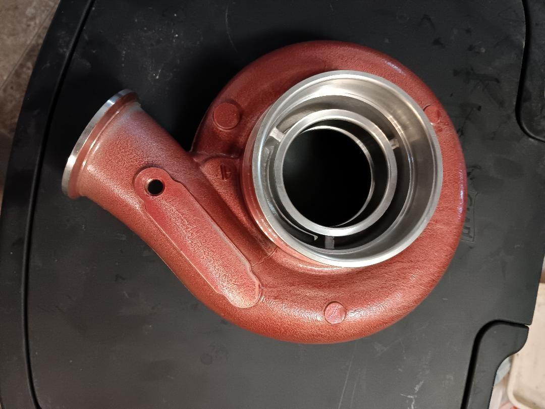

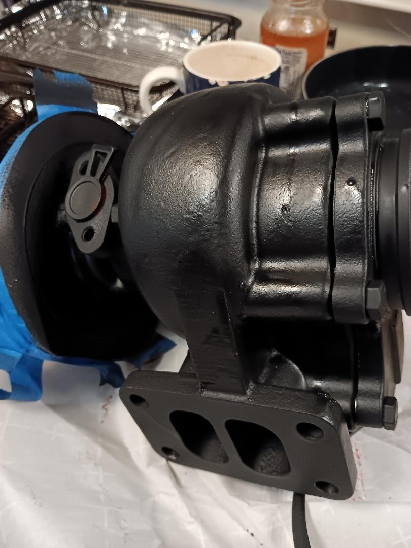

i have a brand new HX35. Will spray on cerakote for guns work good on that?

I would check to see what temps cerakote holds up too.
That turbo housing can get very HOT.

I don't remember asking this. I sprayed the hot side with Glacier Black air dry Cerakote. good to 1600* Compressor I used a clear with red pigment that came out almost pink. Good to 325-350* IIRC.
Yep, it has runs. I put it on thick and don't care
