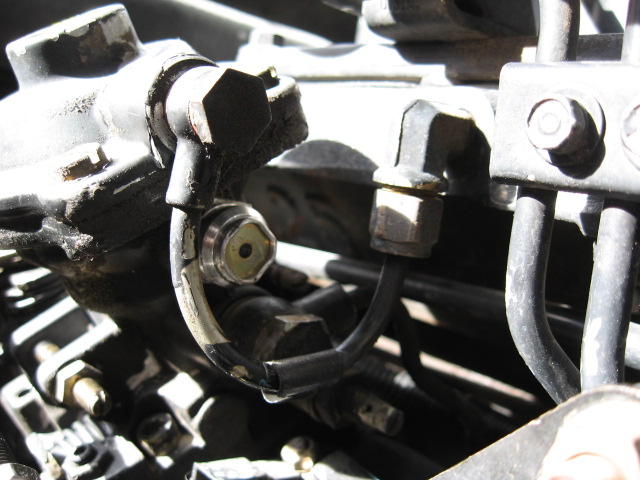

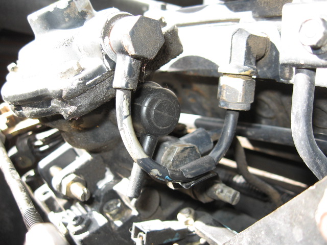

It seemed to have a leak from the IP awhile ago from this rubber cover thing with a vent hole in it (I"ll try to post a pic but it stopped almost that same day so I didn't think much of it, does anyone know the piece on the IP I'm talking about?)
The same thing happened to me in January. A bad O-ring where the action pin goes into the AFC housing was letting fuel into the housing, then it leaked out that vent. My truck did the same stuttering and losing power under acceleration thing. It would quit me on the side of the road and then when I got back it would start up fine. You can order a Bosch seal kit and do the repair without removing the whole pump, just the top.

Well to all those that suggested the shutoff solenoid electrical connection give your self
pat on the back and I am very grateful for all the help and suggestions. Even the replies that it wasn't give me heads up for the future. I found the connection by accident when I barely pulled on it and it fell off replaced both wires with a ring connector and it ran great from Tucson to Phoenix and back. I am back to loving these trucks again. Also the image of the vent thing on the IP is attached what is this and should I reseal it if it leaked once, is it supposed to leak given the design of the rubber boot?Thanks, Don.

That is the AFC vent, it keeps pressure or vacuum from developing in the bottom side of the AFC. Nothing should come out but air.

The aforementioned o-ring (john Mule) leaks, casuing the AFC "well" to fill and runneth over, spilling out the vent. Get it rebuilt, or at the very least, reseal the pump. The ULSD and age compound each other. Local shop in Jackson has been swamped since last fall with leaking pumps.
