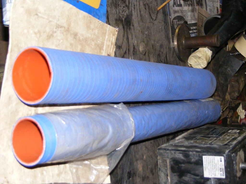

Originally Posted by bgilbert
If you happen to have 'Truck Pro' or big truck shop/dealer nearby, you can buy a 3 foot section of 2.5" silicone coolant hose, cut to length, holds at least 70psi of boost in my application. I use constant tension clamps as well.
i also use coolant hose from my local parker hose supplier
and my 3 foot section only cost about 30-40 bucks
mine looks like this http://i289.photobucket.com/albums/l...s/DSCF4782.jpg
