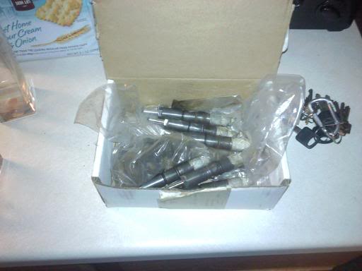

Injector size is 4x.013.
No typo.
Someone wanna guess where these puppies came from? They fit the 7mm head now.
Jon
More info after it is guessed.

Bosch's. Not custom but came stock on another motor.

some non-ic's turned down on a lathe, right?

$115 and $25 for the machine shop. Rebuilt 20k miles ago.
On a horizontal grinding machine.
Yes.

Got it all in and buttoned up...
HOLY COW!!!
You Non-IC guys do not realize how good you have it! From a standstill, I can now burn out through 1st, part way into 2nd and chirp 3rd! With a slush-box mind you.
I have a small problem. Injector number 5 hold down got wet before I changed injectors and now it spurts a fine mist in the 10mins it took me to get home, it soaked the engine in fuel... I didn't notice it at idle in the dark but I did after I got home! Anyone have suggestions?
