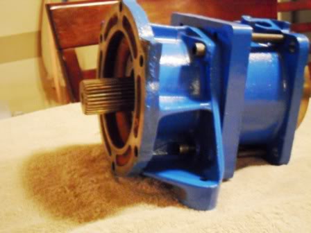

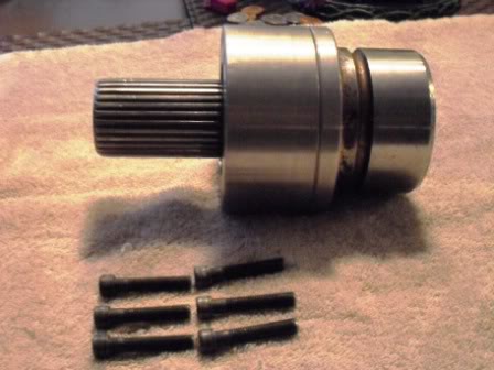

Fuller Trans wirh 4X4 Adapter
I finally got around to fabricating the 4X4 adapter for the Fuller FO8406ASX
The photo gallery are at http://s1231.photobucket.com/albums/...dapter%20Assy/
Here arre a few pics
Adapter
Shaft
Build cost was about $1275
