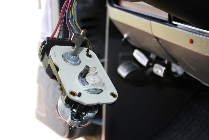

Heath,
Sorry,
You will be ok, you do NOT have to remove your steering wheel to get at your lock assembly. I can see it in my own pictures. I was thinking about the other side.
Also once you get to here, you can unlock your steering wheel.
These are what lock your steering wheel and shifter, all controlled by the position of your keylock.
Jim
