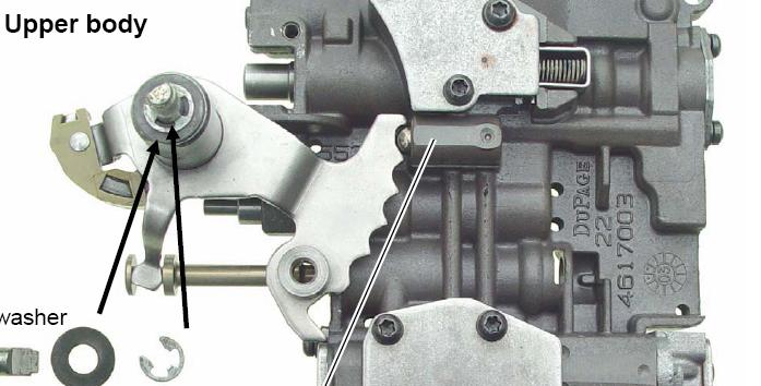

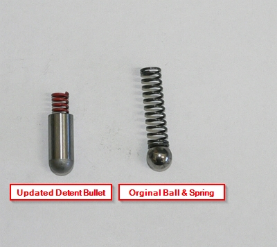

KRB, you need to upgrade to one of these, since you have to remove the valve body to reinstall that shift detent ball bearing, anyway. This bullet style will never, ever fall out. Comes with a stiffer spring. After I put one of these in all the shift slop in the column is all gone. Nice, positive locks on the shift.

I just did a search on A518 bullet style shift detent, and when you see this pic it is an eBay link. That where I got mine from.

You will have to drop your valve body to get that shift detent ball, or bullet style, back in. I believe there are like 6 Allen bolts that hold the valve body in place.
Ah. So is it as simple as dropping it and bolting it back? The valve body I mean, nothing falls or pops out? I'm auto tranny ignorant other than changing fluid & filter and band adjustment.

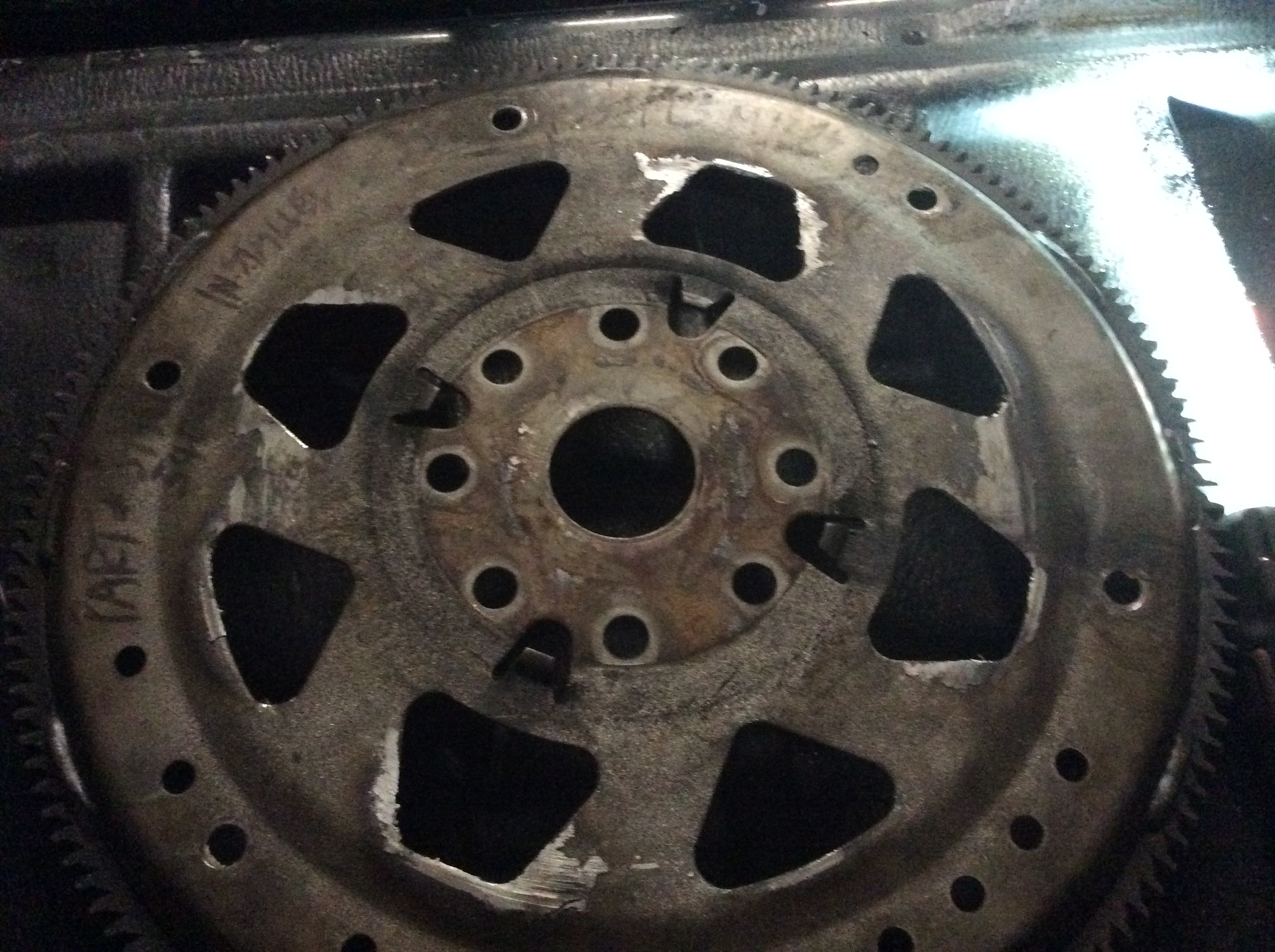

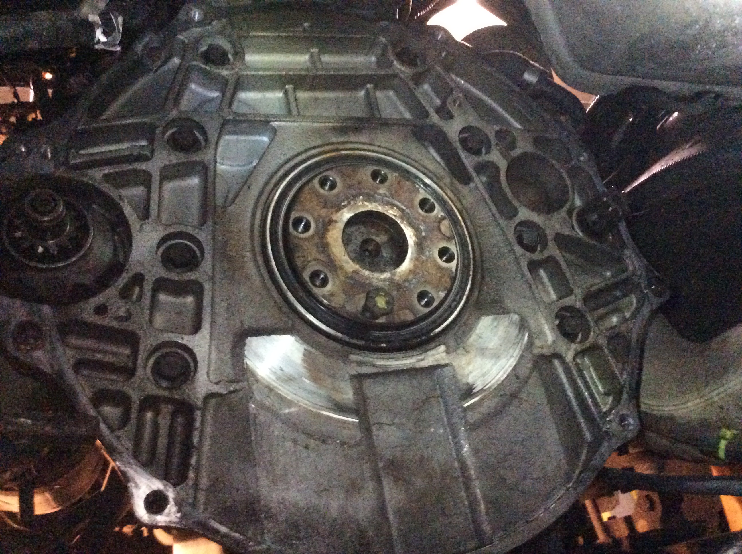

when you pulled your tranny out, did you actually remove the flexplate and check it out? No scrape marks on the backside of the plate or at the transmission adapter?
This was the source of my noise, due to a buster crankshaft thrust bearing. It cause the flexplate to be pulled towards the engine, scraping up the back of the flexplate and this pic of the engine adapter. Noise was a metallic whine, coming from the front of the tranny.

Pic of the backside of the flexplate. If I would not have pulled it off I would never had known it was doing this damage, as the flexplate was not cracked at all
